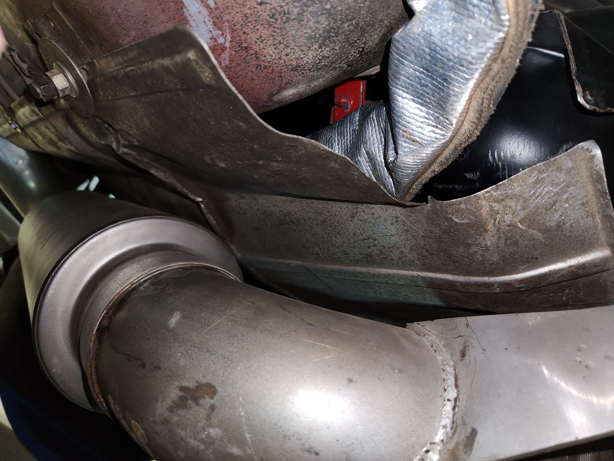

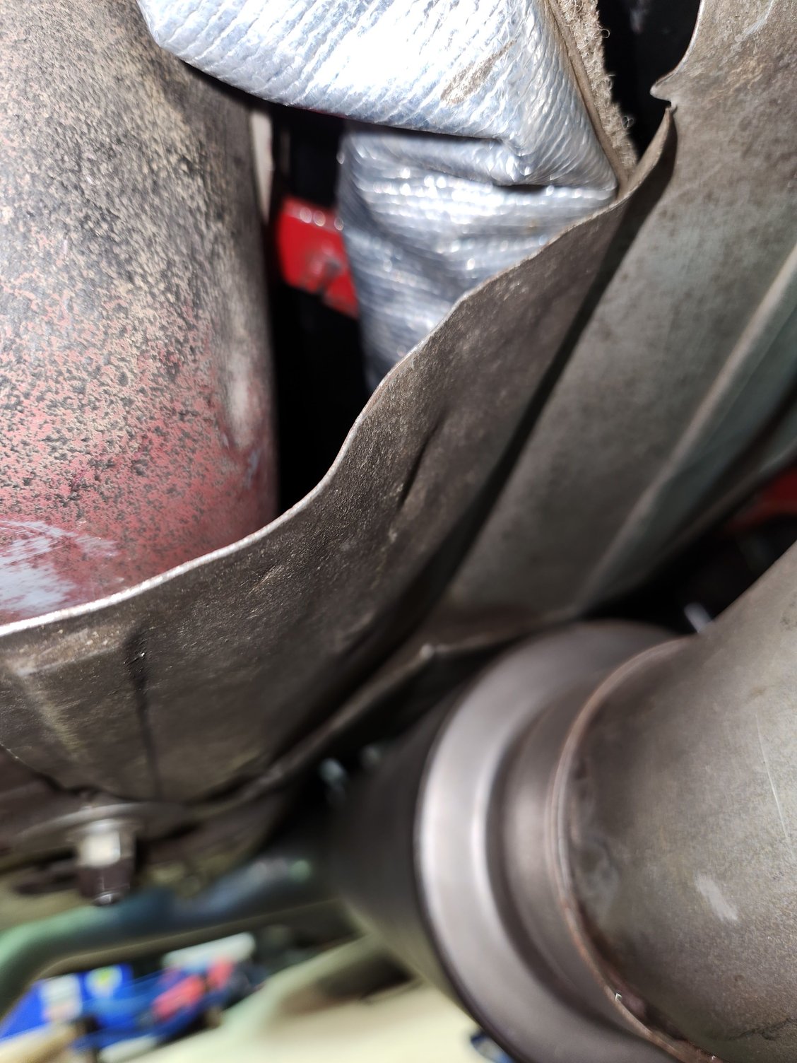

Hi just found this thread and hoping you guys still check post here. I have a 1990 IROC with a fuel tank sump installed. I am running dual exhaust with turn downs at the axel, and the fuel tank heat shields are removed. I want to install a Muffelx 4" single exhaust that will place the muffler back in the stock location. Did you guys put your heat shields back on or how are you managing the heat from the muffler against the tank? I am thinking to cut a hole in the shield for the sump to fit through and bolting the stock shield back into place.

Yes I put the heat shields back in. Just bent them to contour around the fittings out of the sump.
I also have 4" over the axle with a single 4" exit

Re: Fuel tank sump and muffler question
Previous to this muffler, I had a Flowmaster 4" on, and it still fit.
I bent the tin shield around to fit the muffler and the fittings that come out of the sumped tank.
@LB9GTA Awesome thanks for the pictures, its helps and I plan to work on mine this weekend
