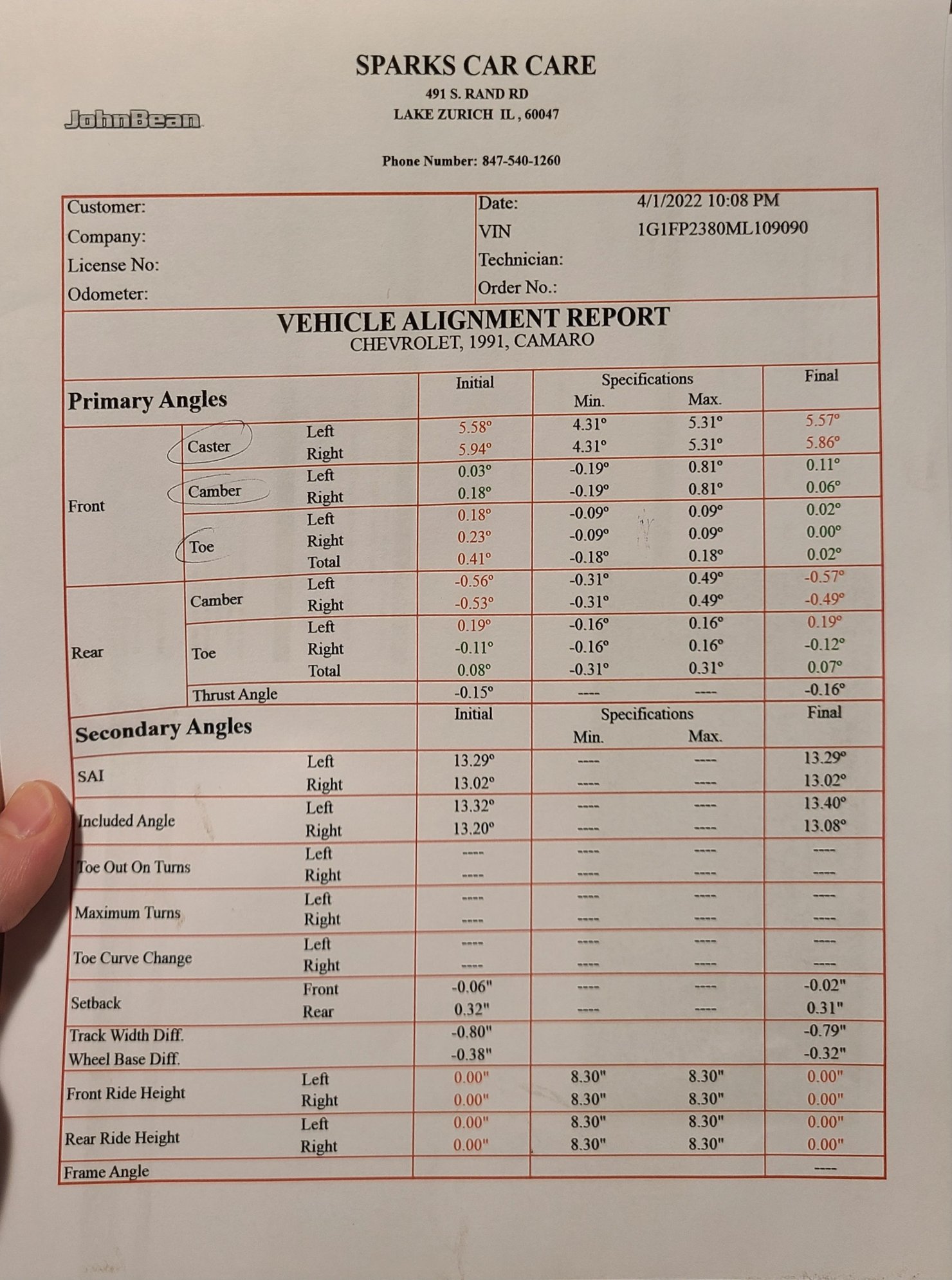

Originally Posted by z28cp
How much negative camber do you currently have up front? Depending on which camber plates you have, you probably want the max amount you can get from your camber plates. I would start at -2 and go from there. Also probably as much positive caster as you can get as well.
I pulled put my paperwork from my last allignment, and ot doesnt look like i have much... not sure if more is possible with the factiry strut mounts, or if it is time for camber plates... im thinking the latter...
What i requested
What i ended up with...
Looks like maybe i could get a little more out of the stock plates...
Or should I just loosten them up and slam them all the way in and back like I've heard repeatedly on here?

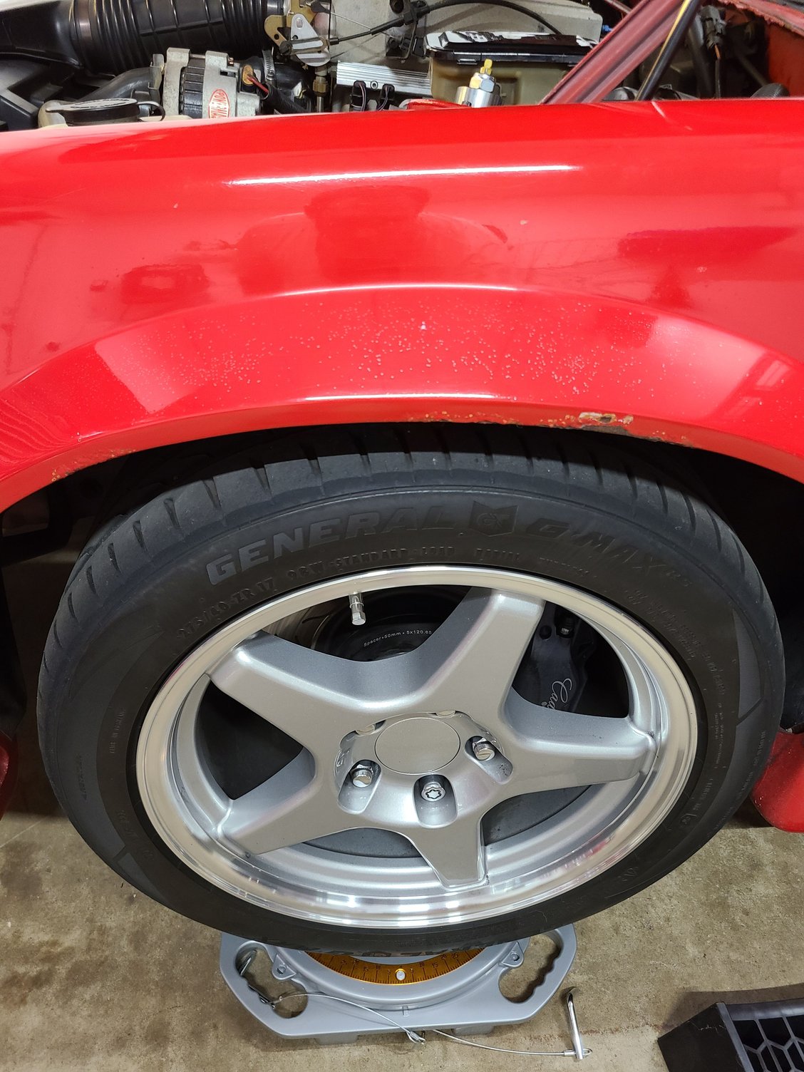

On the tire topic I have literally been hearing since my first event last year that 200 tw tires are a must and will change the whole game... in retrospect I should have gone straight to them... I think my uhps tires are hot happy with me so the rt660s could be in my near future...
Chunks missing?
I'm very glad to hear of others using Edge converters for autocross and being happy with the results! I really think it is going to transform the power delivery of the car for the better!
