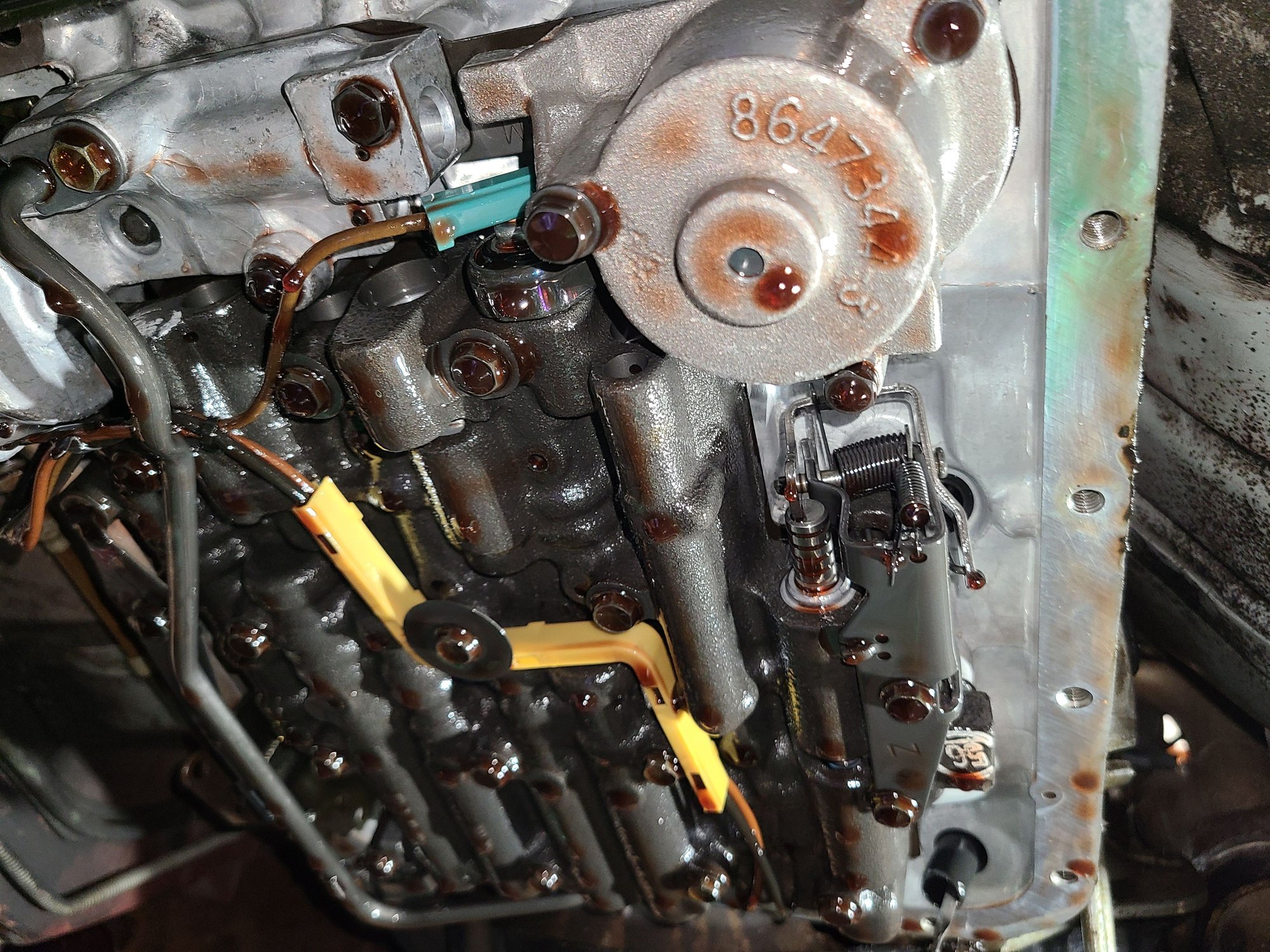

Are these markings inside the valve body or outside? I took a decent number of pictures during the process, but these are probably the best two. Are you able to see what you need to see here? I did check before adding your shift kit, and my car was shifting right around 5k, so I think that is where it was supposed to be. If I in fact have a 5000 wot setup, would you thinking tweaking the governor weights and or springs, could get me to about 5500? I think that is all I'm looking for.

The front of the valve body, facing the motor. There will be the aluminum bushings with the letter/number code I mentioned.

These seem to be the only two pictures I have of the front of the valve body, but I'm not seeing any identifying markings, are you?
Sorry this one is out of focus...
