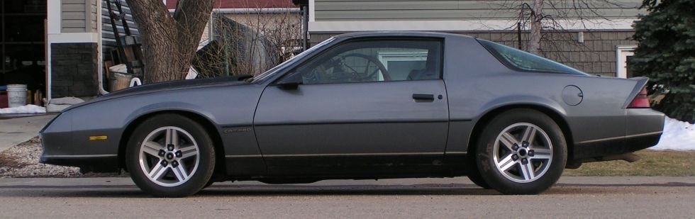

Plenty of information out there. That said I'd like to pull it all into one pile and sort through it.
The subject:
82 Camaro Coupe
3500 race weight (w/ driver)
3.73 rear gear
3800 Edge converter
4L60
Stock suspension (other than LCA relocation brackets and Air Lift Drag Bags)
My racing history has generally been test and tune days. The pertinent take away from that is low track prep. Not always but generally I'd guess to say.
Other history has been Mickey Thompson ET Streets. A bias-ply 26" x 10" DOT legal slick. My current set is aged and the 60's have been progressively worse although there could other factors in that result as well. My current best is a 1.70 flat. That however was a 3.27 rear gear and McCreary Track Star treaded dirt rack tires. (True story).
Now, with the new engine, transmission and converter, I need to get new boots.
The general thinking is that with a low prep traction limited surface, the bias-ply offers a better chance of hooking up. Thoughts on that?
A radial isn't out of the question, especially for the occasional street tour but I'm not wanting to sacrifice my track performance for a better "feel" on the street. The MT ET Street SS is on the short list.
Note: I'll be running an IROC 16" wheel so that limits a few options.
What are your collective experiences in this?
