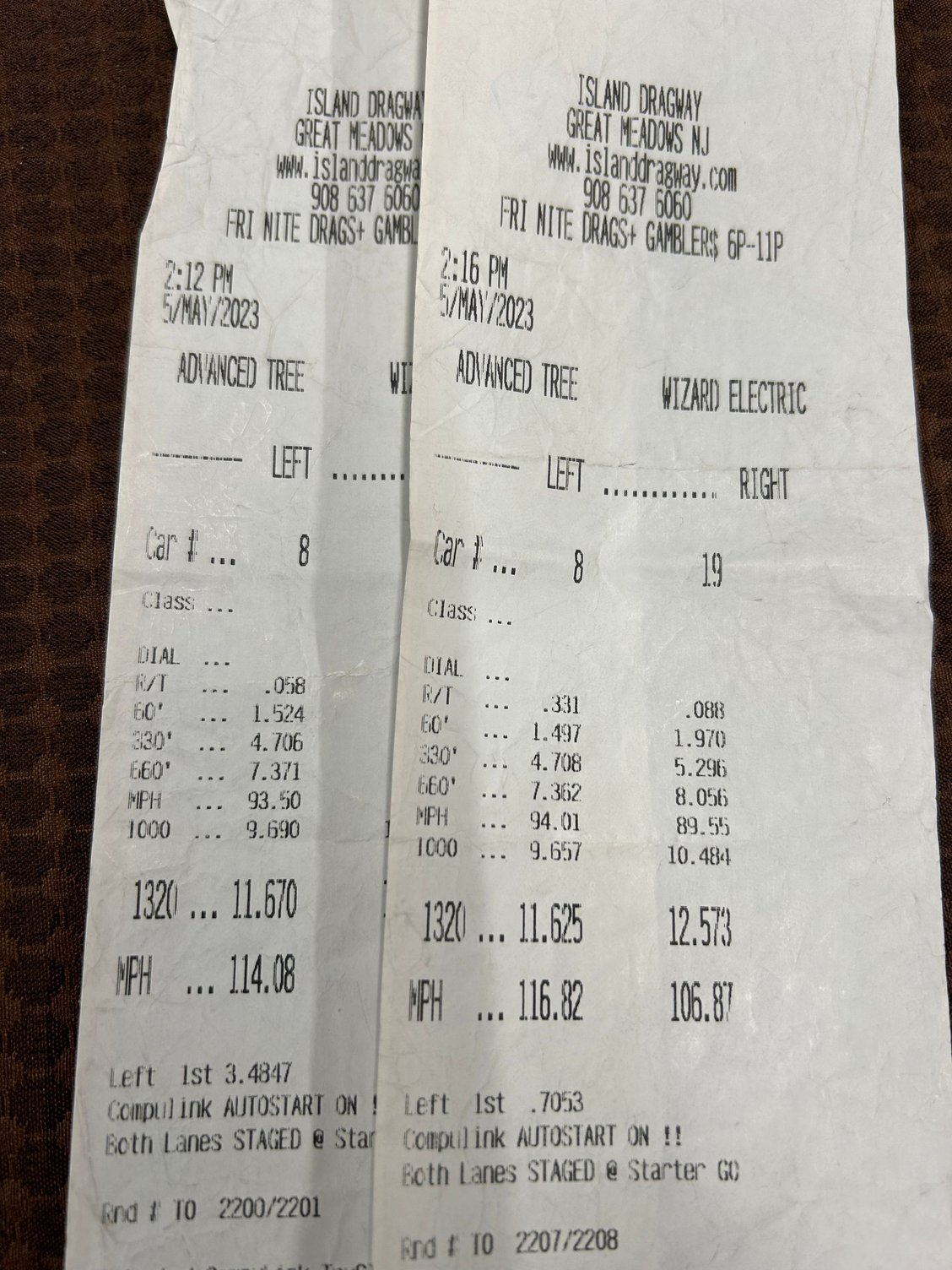

As for the all-motor pass, I also want to get that e.t. and mph better. My best mph was on pass 3 of May 28, 2023 where the car went 11.75 but at 18. 69 mph. It was 95.4 mph in the 8th mile. However the quickest e.t. pass was just a few weeks prior to the one before, and this was on May 5 2023. Pass 4 that day was all motor with 35 deg timing and it went 1.49 tot he sixty foot, 7.36 at 94 mph to the 8th and 11.62 at 116.8 mph that day., the pass right before that one was 11.67 at 114.08 mph with 34 deg of timing. So essentially the car is relatively capable of 11.65 at 117 mph with this converter and this 28" tall rear tire. My buddy John gave me a set of Hoosier QTP 27" tall bias ply tires that I think would be the right tire hight for me to crack into the 11.5x and possible 120 mph territory. Possibly, but its a good goal for 2024.

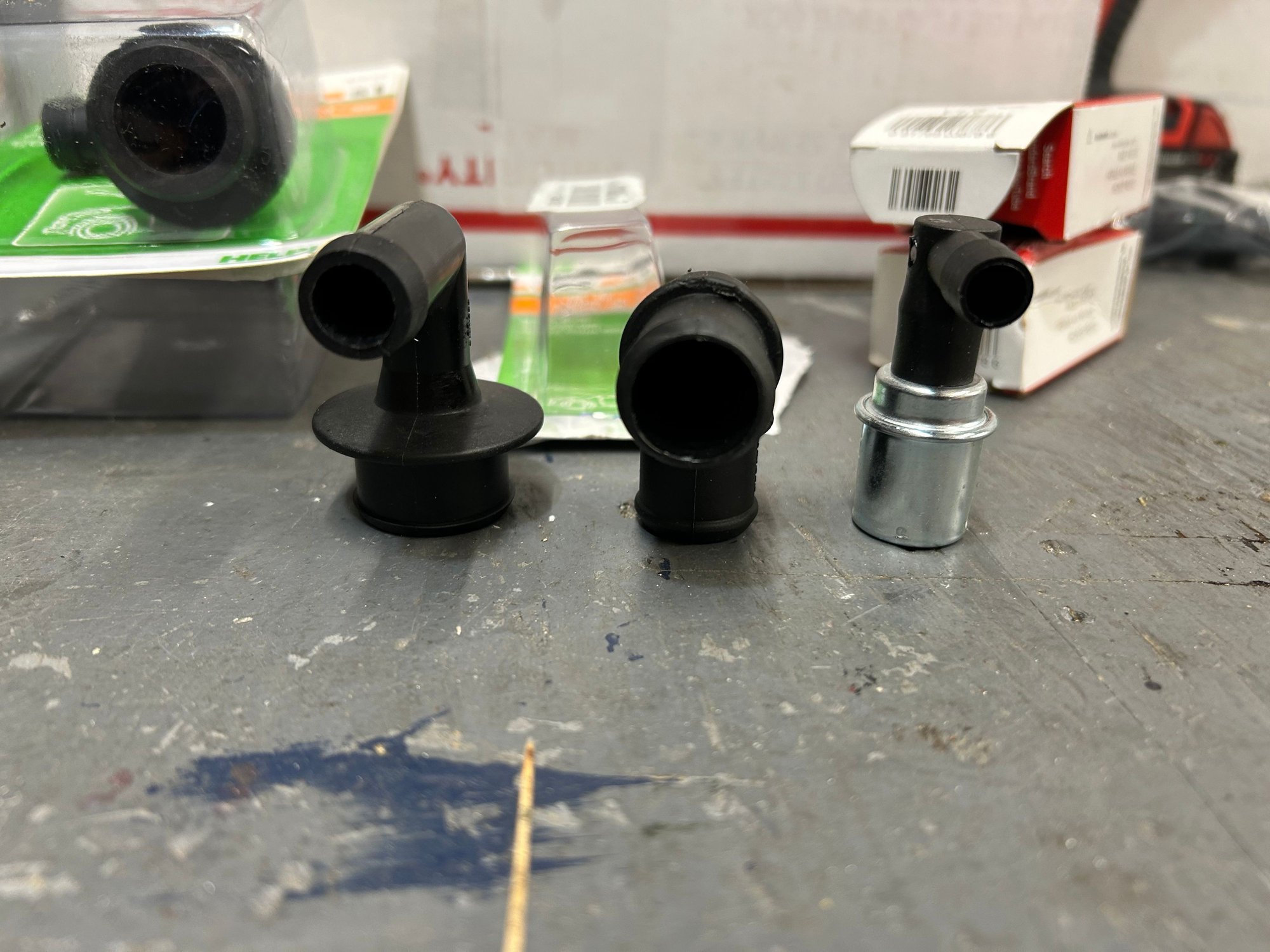

I kept revisiting the aspect of using larger hoses as you guys are suggesting and I think I have a plan to eliminate all use of any 3/8” diameter components from this system. I can use the large elbow in the below photo which has an inside diameter orifice of 5/8”. At some point it will just have to neck down in order to enter the 1/2” fitting that is at the catch can, and I can either use the in/line hose reducer closer to valve covers, or right before it gets to the catch-can. Thoughts ?
also, should I plan on running this 5/8” elbow and hose from both valve covers (like I planned on doing with the 3/8” stuff initially) and then to a Tee? Or would 5/8” hose to a single valve cover be sufficient? Only reason I ask, is I’ll still need to use one of these valve cover orifices for oil fills, where I would prefer to have a tight sealing oil-cap, but if I need the 5/8” elbow and hoses on both sides of the engines, I’ll just have to remove one of the elbows for oil fills.
(the elbow I want to use is the one in the middle of the lineup )

good info here and thanks for steering me in the right direction everybody. I'm still learning the science behind all this, so keep the advice coming!
I decided to find a larger size fitting (Dorman PCV Valve Elbow 47043) to replace the modified pcv valve idea I had planned on going with... and its basically an elbow that i can attach a 5/8" inside diameter rubber hose to and run it over to the catch can. I'll need to bring the 5/8" hose down to a 1/2 hose before it hits the -8an fitting at the can. In the can I will have the stainless steel scouring pad material to help knock the oil down before the flow is drawn out the other -8an at the top of the catch tank. Then it will be a short length of hose from 1/2' ID to 5/8" ID using an adapter because the inlet of the vacuum pump is 5/8. Thats the current plan
- I plugged the breather in the top of the catch-tank cap so that its a sealed system.
- I ran a relay to power the pump with a 20 amp fuse and it is currently triggered off the ignition block fuse panel I built under the passenger side dash.
- got a length of hose from the valve cover mocked-up towards where it will travel and meet the tank. Will mount the tank in the next few days I hope .
- Mounted the electric pump. found a spot almost directly under where the catch tank will be; behind the nose/fender and attached to to the steel bumper at two mounting points, and mounted a 90* home made bracket to the upper area to secure the pump in 3 spots. It has rubber isolators on it too, but I made sure its good and tight. I'll zip off the threads on those long bolts once the whole project is complete.
Turned it on and it fired right up. Sounds loud in the garage. Haven't fired the engine in 2 months so I will wait to hear it that way too. Decided that I am going to soon add in a toggle switch in-line of the pump relay's ignition trigger wire so that I can manually turn the pump on and off. I like doing that with the torque converter, nitrous activation, and so forth, so having a switch for it will be easier for me than building it into any efi based program. I have one un-used spot on my nitrous panel so I ordered a rocker switch with LED light on it from Nitrous outlet to replace the bottle heater switch on this panel.
At the price of about $60, I am probably going to buy a second pump just to have on hand, but I can't help but think of how helpful this will be as opposed to choking down the engine these past 4 years of action.
If I only need the one 5/8" diameter hose from one valve cover, I can finally just put a cap on the passenger side valve cover and get rid of the clunky breather that I've never been a fan of.

He wants to properly vent the crankcase without sucking out all of the oil.
Larger diameter = less velocity.
I can see that but just the same, this isn't a question of evacuating the crankcase then. You want all of those contaniments to get sucked out. The valve cover baffle should handle the heavy oil. The vapours though, from the blowby (if I'm reading IROCZ's intention correctly) you want pulled through a PCV valve, vapours separated by the catch can, and back into the intake all nice and fresh.
The vacuum pump puts a whole nother spin on it so I can see that it's not about evacuation but rather creating an atmosphere and maintaining it. There'd be no breather on an opposite valve cover to the PCV valve. Just the suction of the vac pump. And no valve.
Sound right?
