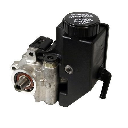

No Emissions: I have never heard of doing that. Very interesting. I can kinda see how it would help the cap/reservoir, but I don't think it will fix my overheated/overworked pump at this time. Also, would this modification just be to add a little more fluid or what does it gain me?
Dyno: I actually have talked to the fellas at Turn-One Steering a few times. They usually setup a booth at the UMI events and last year I chatted with them a bit. They had told me that the type2 pumps are the go-to ones they recommend for what I do. I had the same chat with them last year, that I can't bring myself to compromise on the aesthetics of a type 2 pump under my hood. They understood and said not much they can do for a type1 Saginaw style pump. I forgot where we left the conversation, but that was right around the time I put the DeRalle psf cooler on, and since then I have not had any PSF problems that I know of. Until Friday!
I have done some research online, and thought about calling Turn One again, and I think your post above inspired me to do it. So today at lunch break I called. They said that the type1 pump that I have can be modified by them to bring fluid pressure from the normal 1200 range up to around 1500-1800 psi. We agreed that my pump probably finally failed Due to the hot-lapping, wheel load, g-forces, suspension, sticky tires, and heavy nature of my car. When it failed it is likely that internally it bypassed hte fluid and overheated the internals. Since pumps build pressure responsively, it is likely that my pump is "partially" failed and does not work at low rpms, but comes back at mid and high rpms. Probably an overheated or stuck pressure relief valve inside?
I was quoted about $200 or more to send in my pump to them to upgrade it to hold more pressure. Still not sure that I want to do exactly this yet, but I do need to get back on the road. I have my UGLY oem 1987 pump, but I dont think I will put that back on. In fact, this is the one I would probably send to Turn One, since he said a quality GM OEM part would be better for them to work on, as compared to the pump I just burned up, which is basically a reman unit or inferior product. Maybe I will do that this winter and they can take their time with it, and also send it out for a chrome plating finish afterwards. In the meantime, just to get me to some car shows and the dragstrip for the duration of the year, I might just get another type1 pump like I had. Simple bolt in and fill with fluid. I have found them as low as $104 but usually around $150.
this ebay one is located in NJ only about an hour away, so I could have it here soon and install it this weekend
https://www.ebay.com/itm/22440197079...evt=1&mkcid=28
or jegs
https://www.jegs.com/i/OER/691/A9500150/10002/-1

Got the tires pulled from the old cracked jegs wheels, and put onto the new jegs wheels. I am digging the look!
Got the replacement power steering pump delivered yesterday and installed it today real quick. I am not expecting the world of this thing, but it will allow me to street drive, drag race, and car show until the end of 2021 season. During the winter, I plan to send one of my old power steering pumps to Turn One so they can upgrade it to run at a higher pressure. Total cost for this pump was $89 delivered. It was ebay for $104, but it arrived with no chrome cap and the seller said they did not have any more caps to give me, so he took $15 off the price and he is refunding me $15. Luckily I had an old chrome cap in my parts stash, so I just used the old cap for this new pump!
Power steering pump madness:

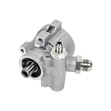

LS engines use a Type II pump, so that's probably what Detroit Speed uses. Although, it's likely been modified for higher operating pressure and less flow rate at high rpm. And they probably use a Delphi 600 series steering box, same as sold on their website. The pump has a max speed rating of 7000 rpm continuous (pump speed) and 7500 rpm intermittent.
Your reservoir is burping because the pump flows too much fluid. Stock pump flows a grossly excessive amount of fluid as it speeds up, and the majority of fluid is bypassed internally and returned to tank. The constant pressurizing, bypassing, re-pressurizing causes temperature rise and the fluid overheats, and tank pressure builds until it burps out the cap.
Type II pump is the way to go, man. It inherently has a lower flow rate and consumes less power (~8 Hp) than Type 1, and it's more modifiable (is that a real word?) than the Type 1 pump. But even my stock LS1 F-body pump burped fluid at high rpm on the street; and other F-body owners have experienced the plastic tank melting during autocross. I had the pump modified by Turn One. They dialed down the flow rate and increased operating pressure to 2000 psi. That solved the burping issue and decreased power consumption another 3 Hp. That's ~12 Hp difference from your existing pump! And it's something you need to do anyway, so..... it's "free" Hp if you're doing the hotrod math.
Use a cooler to keep fluid below 275° and things should be fine. Use f
ull synthetic fluid. 2000 psi is suitable for tires up to 18x10 and 100 treadwear. Higher pressure goes unnoticed when you don't need it and won't make the steering feel soft.
As far as looks of one pump versus another, I like the look of stuff that works....

Originally Posted by QwkTrip
...And they probably use a Delphi 600 series
Here's what DSE has to offer. Looks the pump is convertible so as to allow a remote reservoir. That might tidy up an engine bay somewhat.
https://www.detroitspeed.com/82-92-c...inish-090204-1
https://www.detroitspeed.com/82-92-c...stalled-090301
https://www.detroitspeed.com/82-92-c...servoir-090901
