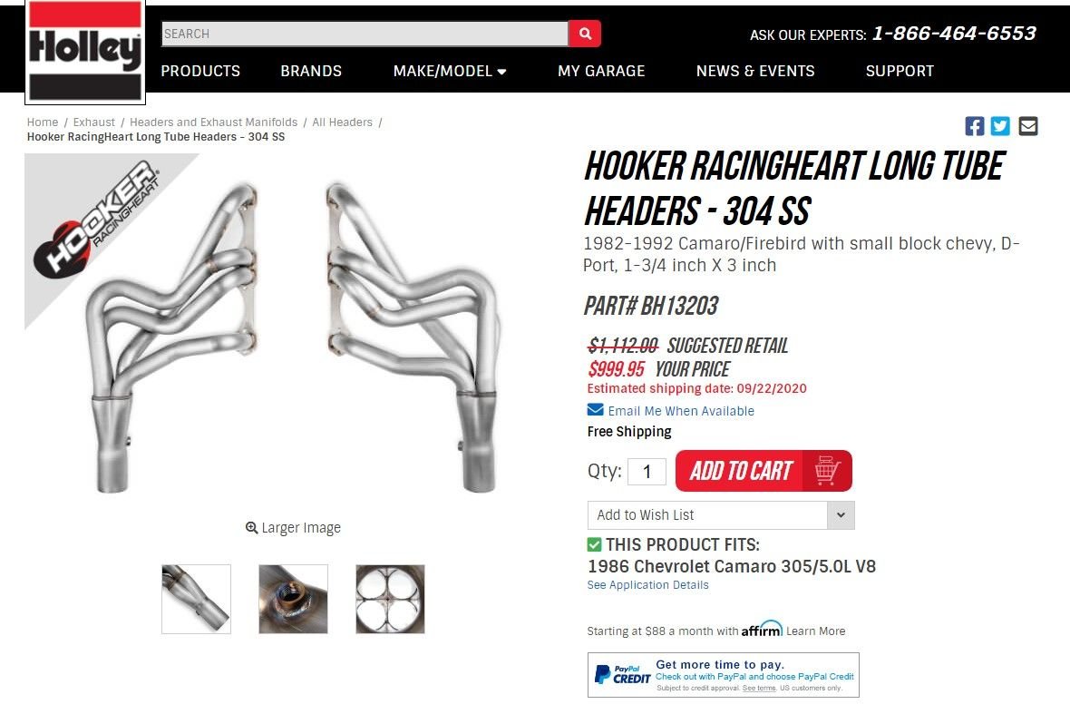

Seems that Hooker has just released what I think would be the ideal header for you.
https://www.holley.com/products/exha.../parts/BH13203

Ran out of money for a proper exhaust for this year. Current setup is a 1 3.4" DynoDons mid-length headers, to the Dyno Don Y-pipe and no cat. then it meets a 3" hooker cat back which in installed a 3" DMH electric exhaust cut-out on too. I actually removed the "cat back" this past weekend for the track, but it made no difference mph wise. Depending on my budget, my hopeful 2021 upgrades would be a nice set of long tube headers to a 3.5 or 4" exhaust. Since I plan to run a 200 shot of nitrous. there is NO way my current exhaust will support that. any recommendations
Also, I went to the track yesterday, last session of the year. it will take me a few days to get the videos, photos, datalogs completed, but i will be sure to update this post soon.
I've been researching and using software to determine what the ultimate would be in terms of an exhaust system. The operative word here being "ultimate".
From results demonstrated by thousands, a long tube header will provide the best result. This is one which is sized correctly for both primary diameter and length as well as secondary diameter and length. Ultimate here would mean an open exhaust with a collector extension of the appropriate length. You can see how this might exclude a complete exhaust and muffler. But again this is "ultimate" in its approach. One only has too look at the fatsest class of drag racers that use a conventional header to see that this is true.
PipeMax has provided much of the needed data for a well designed system. It seems to be the go to program for this.
Now that said, having no exhaust isn't entirely practical for every application. The second best approach is one which uses cutouts. These however can't be placed just anywhere. It has to determined exactly how far back from the primaries they need to be. Again, PipeMax. Placing the cutout in the wrong position, which directly affects the collector length may hurt performance more than it helps. Witness the poor performance when running headers with nothing on the secondary other than the flange such as when you're on the way to the muffler shop to get the rest installed. Torque falls through the floor. The correct length length will enhance what the header is designed to do.
​​​​​​The photo below is a decent representation.
What happens after the cutout would be a matter of preference regarding fitment and sound. If you're a little choked with a single 4", which would be debatable depending on how thin you want to slice the performance results, opening up the cutout will allow the header to do it's job. And that's to provide the proper amount of pulse tuning, thereby increasing volumetric efficiency and output.
At least, that's the way I see it having been working out these details for a while.
As for you updates, looking forward to it.
