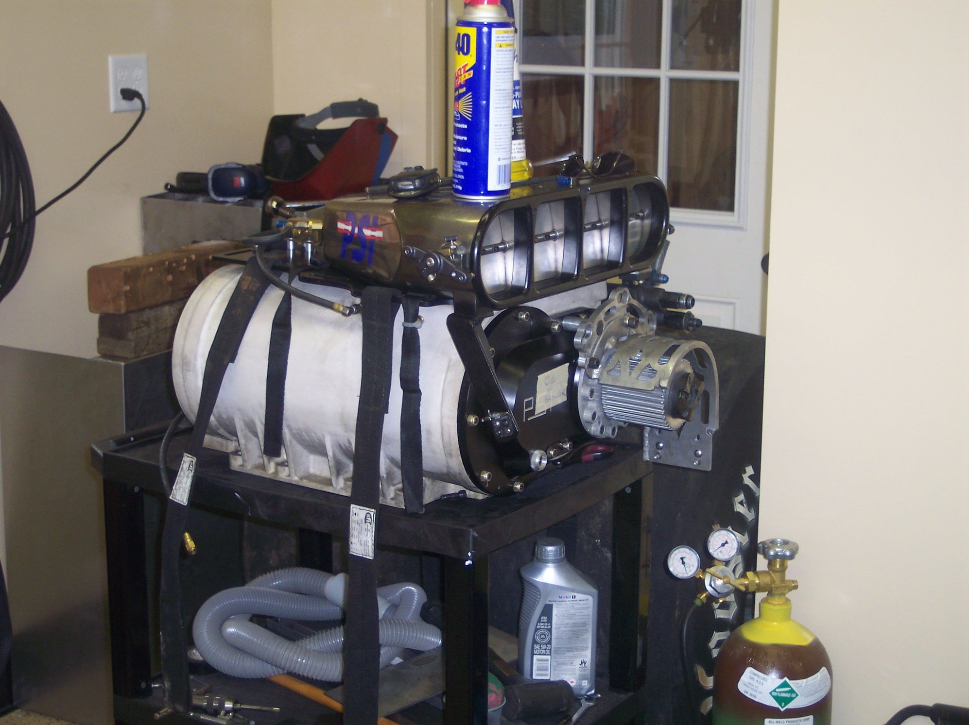

I had mentioned here that I was looking for a Funny Driver...
I am going to part-out the Funny Car, and change over to a Dragster.
Anyone have, or want to earn a NHRA Professional-Sportsman Level 2A License... instead of the 2B License?
Top Alcohol Dragsters can run a Blown Injected Alcohol Hemi, like I have in my Funny Car...
or they can run a Normally-Aspirated Injected Nitro-Methane Hemi.
Similar to the Image below:
Top Alcohol Funny Cars are not permitted to use the Nitro-Engine.
These Engine look similar to the Image below:
Both Engine types make 5,000 to 6,000 HP.
But the Blown Alcohol Engine launches at about 7,000 RPM...
and makes Peak HP at about 11,000 RPM.
The Normally-Aspirated Nitro-Methane Engine launches from an Idle of 1,500 - 2,000 RPM...
and makes Peak HP at about 6,000 RPM.
If any of you are interested in Nitro-Methane...
It will approximately TRIPLE the output of an Engine compared to Gasoline.
Also if I tried to run my Blown Alcohol Engine on Nitro-Methane...
It would produce even more Power than the fastest NHRA Top Fuel Dragsters and Funny Cars.
The Blown Alcohol Engines have a TON more Camshaft, more Compression, and a way better Super-Charger that makes more Boost.
