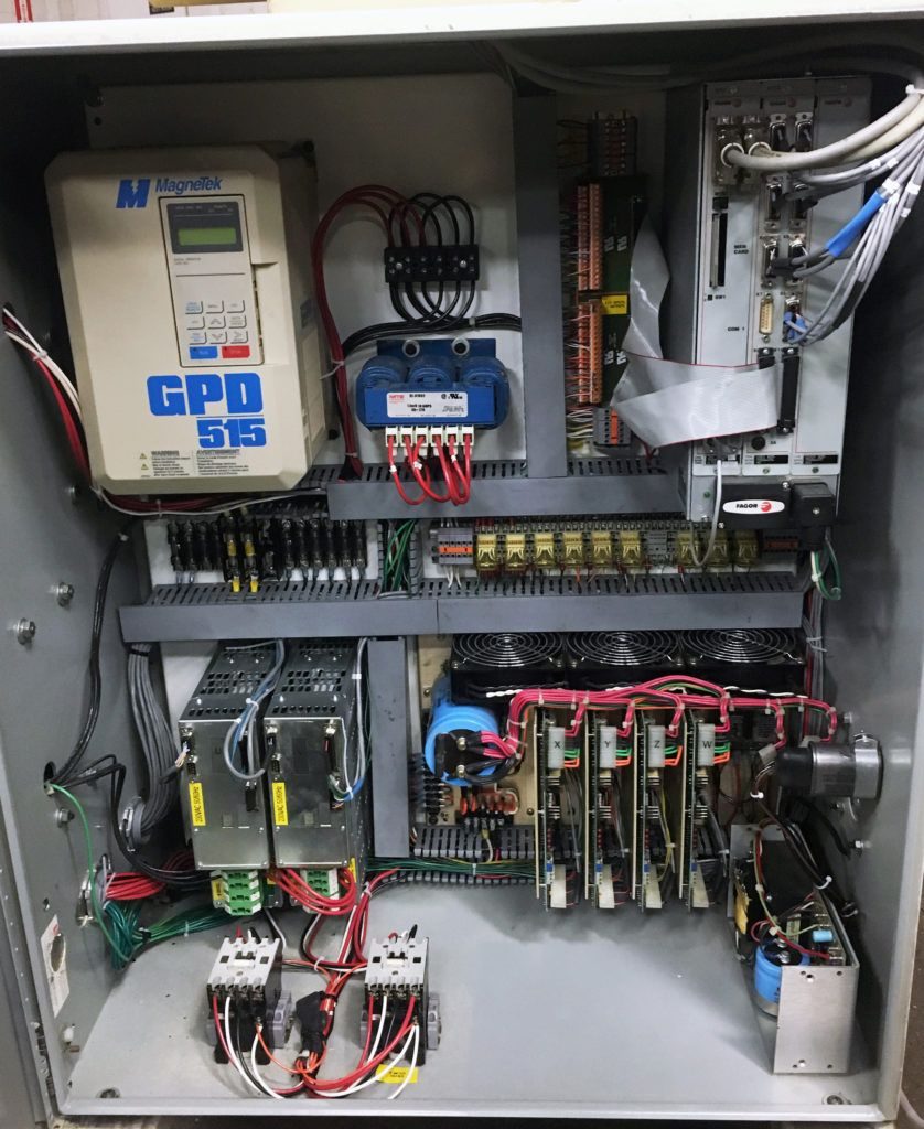

Not being there to see and examine makes it difficult to diagnose but being a wireman/automation electrician/etc. leads me to one possible conclusion.
Wiring.
Specifically, wires to ground/negative.
One thing we've learned with regards to EFI and all of the electronic bits that go along with it is that the grounds have to absolutely solid. Further to that, they should all go to the same place.
Taking one bundle of wires and connecting them to a bolt on the engine, then something else lands on the fender, then the firewall, is a recipe for trouble. It matters little that all of the subcomponents, i.e., engine, heads, sheet metal, are connected with "x" size wire. Having one point of termination can eliminate sources of RFI noise, voltage variances and similar. Worse still, having the battery in the trunk and relying on the unibody for a ground path invites failure.
The size of any component bond must also be sufficient. Remember, you're only pushing 12 volts around. Resistance goes up more than what you might think. Especially when the loads increase.
Is it possible for you to draw out (a hand sketch is fine) to show where all of your various grounding points are? I'm guessing there are a dozen or more.
I may be missing the exact nature of the issues your having but this is what we've learned and developed over the years.
You've visited QwkTrip's wiring thread. Vorteciroc has some very keen insights into this sort of thing.
I'm just throwing this out there and maybe something will stick.

Thanks for the props Mr V but I'm not here to impress anyone. As a forum member I look to help if and when I can.
That said when you go from this...
Before troubleshooting...
To this...
After
You learn a thing or two. FTR, I'm not taking credit for the housekeeping in the pictures above, but it's often what I'm up against on a daily basis.
In an automotive arena, for general repairs, a good schematic is a must.
For hotrodding, I build my own drawings as I go. Case in point, is my gauge cluster. Without a map, I'd be lost under the dash after being away for only a week or two!
Maybe the ideas tossed out here will help our OP come to the source of the issues.
