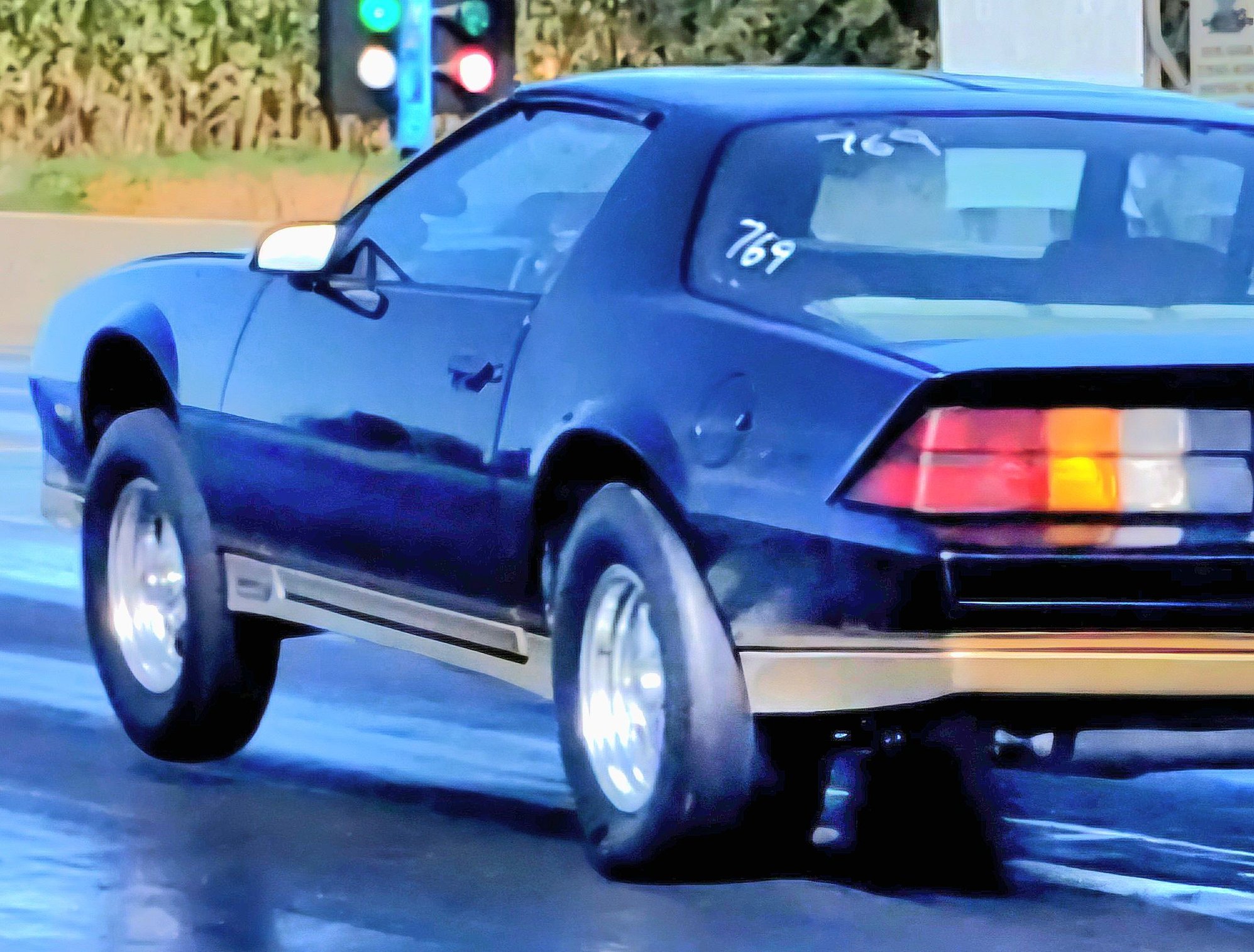

Oct 28, 2024 | 12:37 PM
My '84 Camaro just doesn't seem to like M/T ET Strret-r tires. They are 275/60-15 and they just don't want to hook. My car isn't that fast. Guys FLY on that tire and my high 11 second car just spins them. On the occasion it decides to hook, I have a best 60' of 1.55 out of 10 runs on two different weekends, there are probably 5 that are in the 1.5* and the rest in the 1.7 and 1.8. On the 1.55 run it went 11.68 at 113. But a 1.8 60' and I run 11.96. It is frustrating. This pic was 11.82 @ 112 with a 1.56. This lat time out the weather was cooler, tweaked timing and the carb and had a couple 114mph. I feel the car can run 11.5* IF it can hook

Oct 28, 2024 | 04:15 PM
Re: Maybe expecting too much from Street ET-r
In that picture, you see that it does get the tire up. But it just yanks it up. It doesn't have the power to hold them up, so maybe it is then unloading the rear? Would 90/10 or 70/30 be better than the old original struts? I don't think the car needs a fancy or trick adjustable strut. Also what about the rear shocks? I don't think the rear Competition Engeneering adjust the way we want? Their website says the rears are 30/70, 40/60 and 50/50. 30/70, I take that as they will resist letting the chassis separate? But squat easier?
