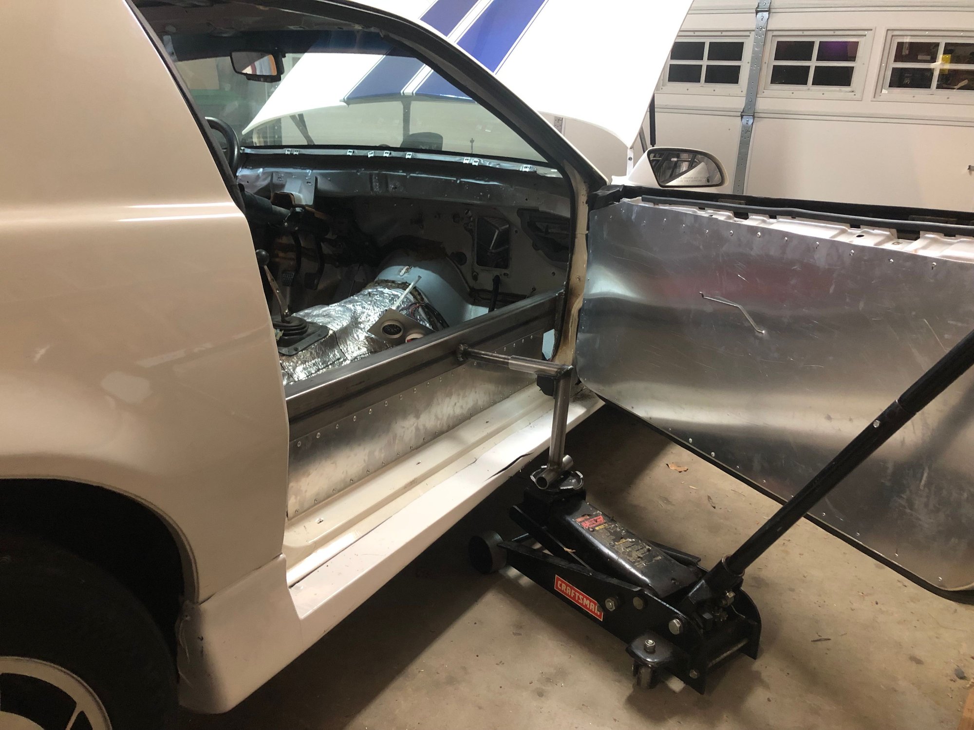

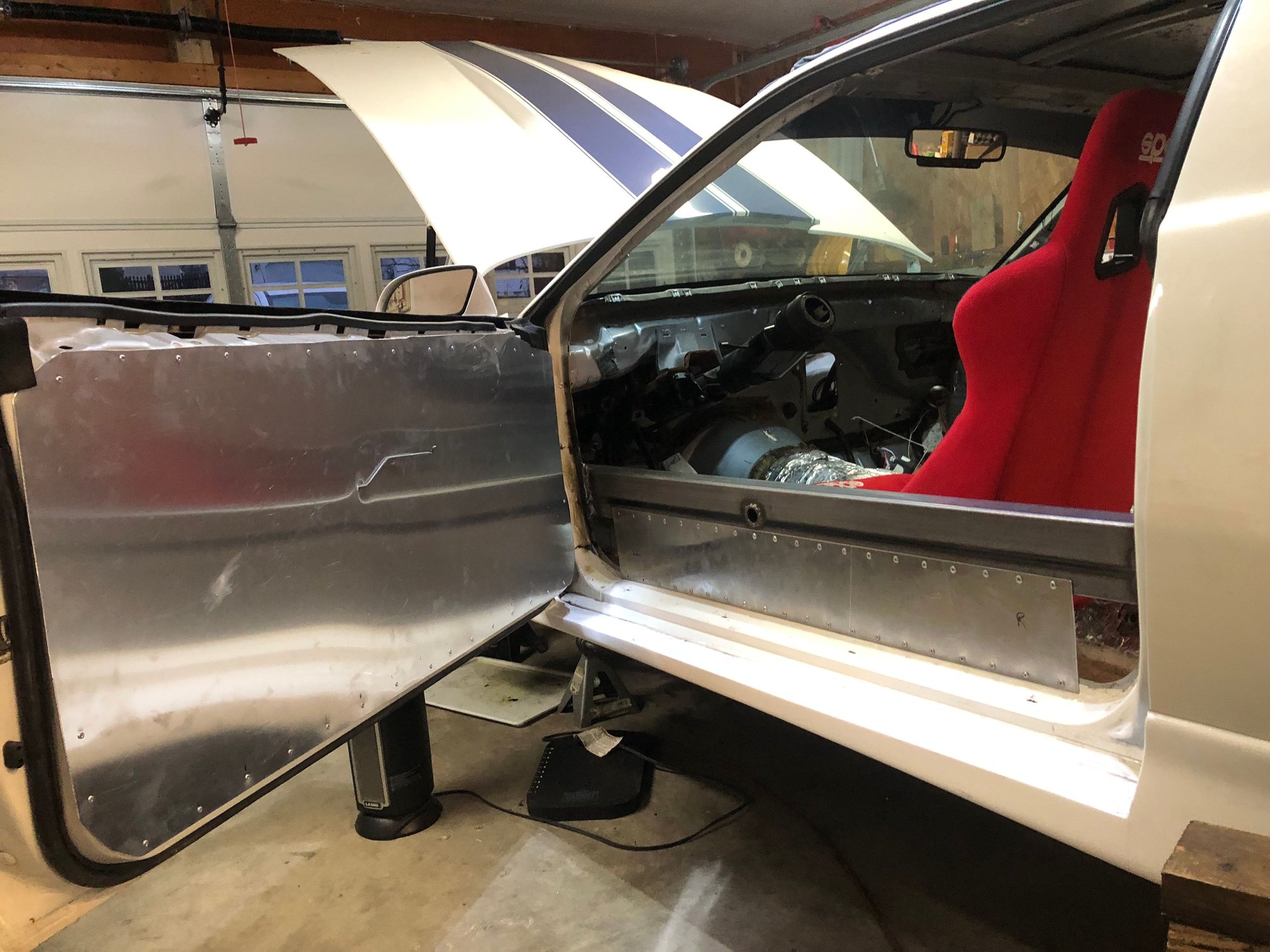

I thought posting some pics and description might be interesting to some like-minded thirdgeners. I wanted to stay away from a full cage, but, the chassis needs bracing and I'm too old to scrounge around on the concrete finding a place to jack up the car. The door bars are 2x4x.083 steel tubes, welded in at each end and then riveted to the door sill with .060 6061 aluminum. Most of the rivets are 3/16 CherryQ structural rivets. The jacking system works, just don't shim with a piece of wood. See the crack in the rocker panel aero.

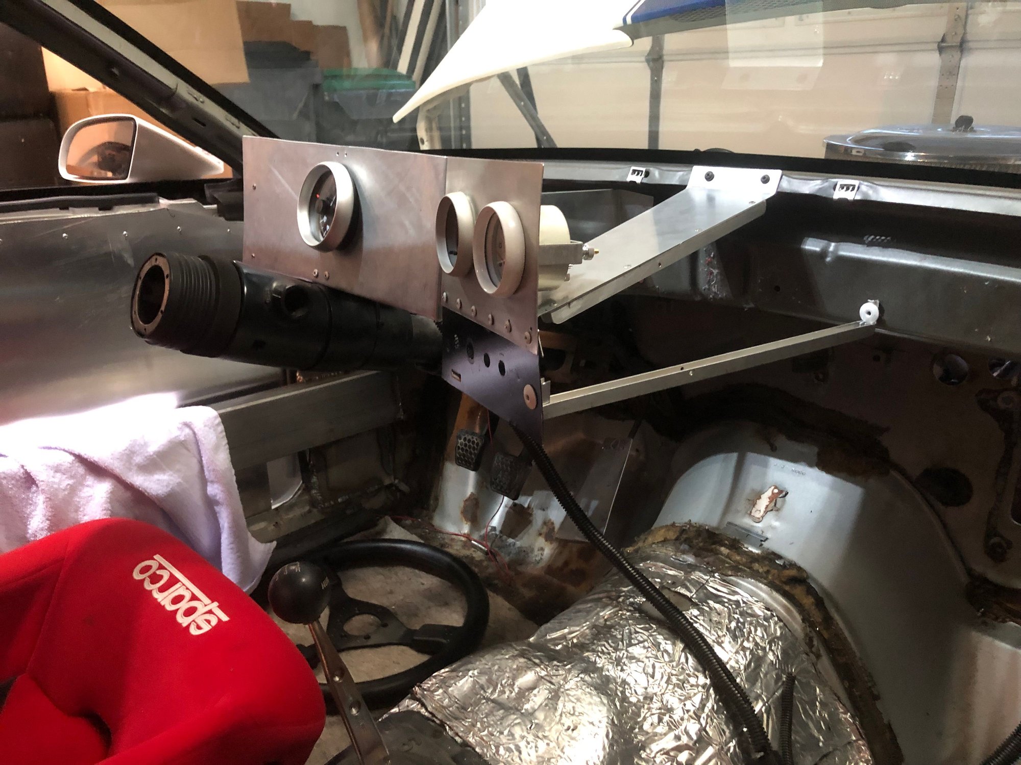

The foil you see is sound insulation put in by the previous owner. It's stuck on pretty good.

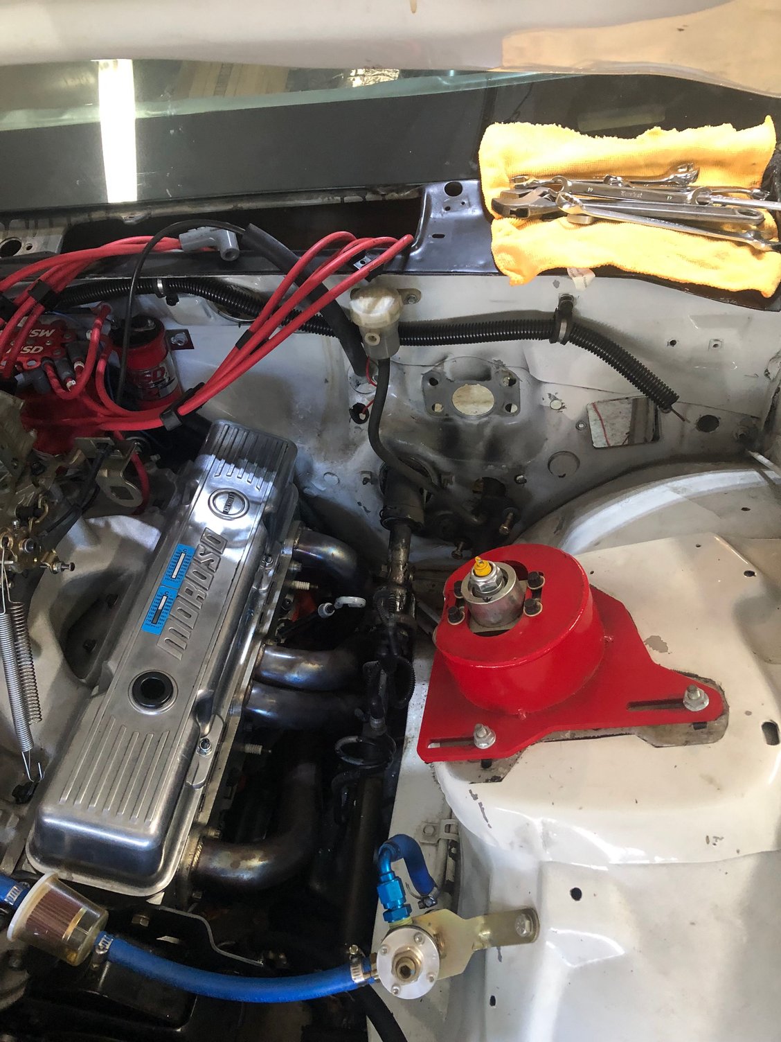

The first 2026 event is 3/15 at Dominion. I am excited (always a bad thing) to see what the changes do for lap time= Better headers, chassis bracing, manual brake conversion, lower rear ride height.

The Friday was a nogo. It was so close to being done. I'm glad I didn't try to force the issue. Attaching the padding to the door bars took more time than expected and I used the pressure bleeder again and the brake pedal firmed up, that and 10 other details. The next event is this coming Sunday. Whatever happens, I'll post afterwards.

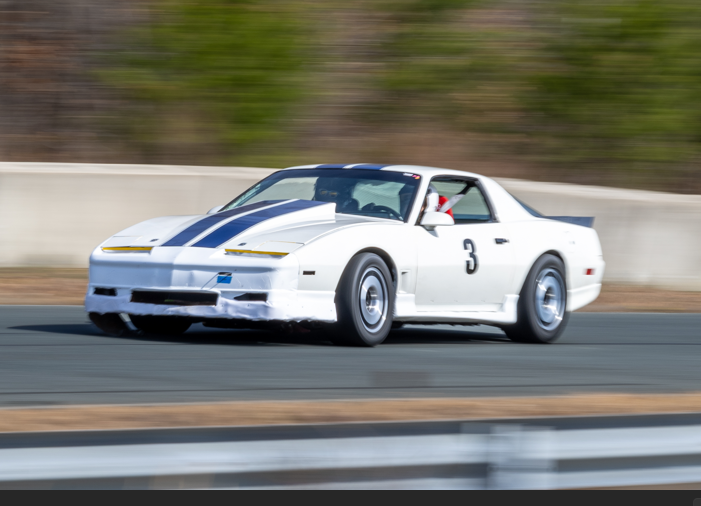

link to youtube clip. The spin is around 4:10. This is the first session and I'm surprised at having difficulty shifting. I came away from my heart surgery with nerve damage in my right hand. Too much rear brake bias. The gravel separated the exhaust and so, had to go into the pits for repairs. Then I forgot the camera on the second session. The exhaust came loose again so I called it a day.
Conclusions: Engine had power, 7000rpm in 4th gear. The car turns in nicely with the lower ride height and new trailing arm mounts. The manual brakes have good feel and not too much effort. Experimentation with brake bias needed.
Driver had issues with right hand making it difficult to shift. I couldn't see over the hood bulge looking for right hand apexes. It will have to be cut down.
