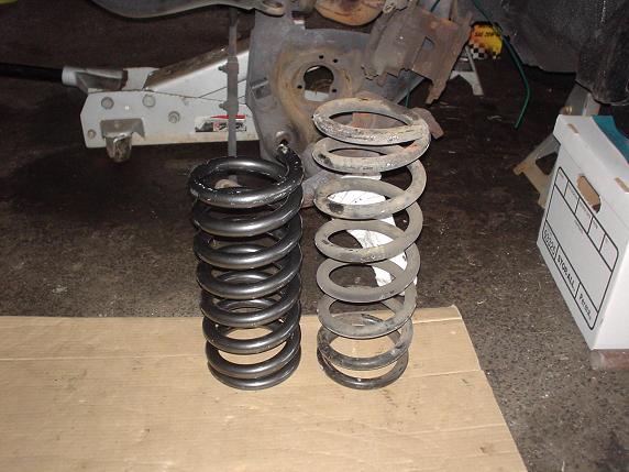

Almost forgot the comparison pic
Attached Thumbnails Eiback & Bilstein-stock-vs.-eibach-pro

Originally posted by acescarrsRS
Update! Finally got off my lazy a** & started to install my goodies. I'll post pics when I'm done. I just started the fronts today. The new springs go in sooo much easier than the stockers! Gotta love shorter springs.
Are you going to change the upper strut bearing and spring pad?
Also is a great time to install polys....
The upper strut bearings are a little newer. (They were replaced a few years back) Also, the scary thing about doing these simple type of swaps is the attitude of, (oooooohh everything is apart. I can change this, that, etc......lol! ) which can be both a good thing & also a very expensive one.
