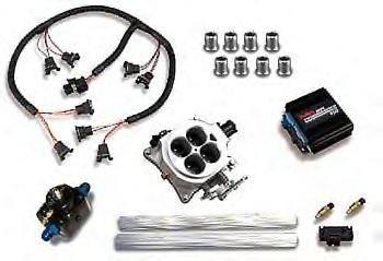

A TBI might not actually do anything for fuel economy, but I am sure you are on track with an EFI idea. maybe an 8 injector plate sandwiched between the blower and manifold and the commander 950?

what I mean is to use this kit (see pic) and the 950 instead of the TBI kit and the 950. the TBI's are EVIL

<b>what I mean is to use this kit </b>
what kit is that, how does it work, part number = ?, fuel economy is like..., where do i get it, how much is it.
heh, sorry for the list of Q's, maybe just a part number then? I cant find it on holley's page but I could be blind as heIl too...
