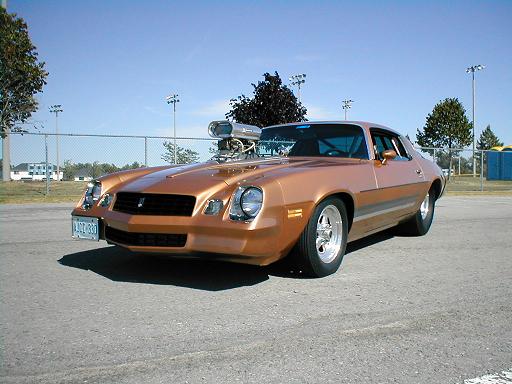

Here is a little taste of one of the machines I built. 10.30's at 130mph. All out of a power glide.
With a 4000 stall, now it bears a 5500 aluminum 2 piece stall, haven't had her out yet to see the results as it is being painted Black.
Here is a shot with the rims and tires. All 15'
With a 4000 stall, now it bears a 5500 aluminum 2 piece stall, haven't had her out yet to see the results as it is being painted Black.Here is a shot with the rims and tires. All 15'

ok got nothing to complain about it at all. great looking car. it appears that you have a little time and money on your hands. Why don't ya try non-oldschool techniques? i mean maybe try out my idea. if it don't work sell them to some stupid d00d with a suburban. all i'm saying is try it. a large rim, with a tire for traction.

Simply for the lack of sidewall as mentioned before.
Look into what 95% drag racers have out back should be explaination enough.
Increasing diameter of a rim will not help traction, now adding width and matching tires will.
I suggest you learn your drag science from something other than usually wrong magazines and spend some time track side and in the pits.
I know my Malibu runs faster than what I have posted, but I really don't care for the I'm faster than you arguements, BTDT not wasting any more time with that.
Anything more than 2/3's throttle = wheelspin in all gears.
Stage 2 is going to be even more... should be good to low 11's, possibly a high ten with slicks/dragdot's. But thats next year...

Heard it, been in it, and seen it in action, I think Saturn's car is just flat arsed neat.
Having seen it as a WIP.
lol, i havent seen it IRL, but it looks neat from here too
im only starting into FI and serious fabrication, but lets just say that his setup has inspired me...

He sure has built a winner! Ill admit to that!

Your project is turning out bad ***!
I'm waiting for sound clip!
Can you email me some close up pics of the blower mounting, front & rear?

my new laptop has a sound card.. I'll do a clip today and take some close ups of the mounting plates.

I happen to like seeing a car where talent, and patience have won over throwing money at a project.
Quad4 ecm, driving GN injectors, on a 305 with S/C off some misc ole vehicle. Toss in some good brakes, a 9" rear end, and smooth body work, and that folks is a nice ride.
As for the 18 tire comment, it's meaningless, and not even relevent. As for age claims, and IQ, again, meaningless.
If it ran 18's, that would not lessen the talent that went into it.
Life ain't only about the 1/4 mile for some folks.
Having a driver that collects a crowd everywhere it shows up is fun. So far at the 3-4 local cruise-ins, I've seen it at, they're always folks standing around finger pointing and going, gee that's cool.
And while 10 sec rides are fun, there is something to be said for car that can just light'em at will, when going to the 711. No mixing fuel, no fartin around with finicky ill mannered sorta run calibrations, it's just hit the key and go type of car.
And while book learning can be informative, nothing beats actual underhood time for learning what works. And with the magazines hiring literary majors, all they really worry about is spelling and grammar. And they can report some of the silliest stuff as fact.

Just wanted to congratulate you on an awsome looking project. I think your engine bay wins the contest for cool points on this board edging out quite a few of the other very nice cars. That thing must be a low end torque uber-monster with TPI+Positive displacement. Have you had a chance to do some dyno tuning yet?
SATURN5,
He and I went to a local cruise last week, me in front, he in his GN.
Turned on to 5 lane road and stepped into it in second gear..
instant whine, and tire squeal/smoke..
made some poor lady in a Honda in the next lane do her best Exorsist head spin.. Grumpy said she looked like WTFWT???
I need to find my mic....

Ah found my mic...
2 clips available, one is at idle, the other revved.
Mic was sitting on the hood. Yes it is loud.. can be heard at least a block away under throttle...
http://saturn5.homestead.com/files/idle.wav
http://saturn5.homestead.com/files/rev.wav
Enjoy....

Saturn, that sounds really familiar… just about the same noise my brother’s car makes with one of those, but imagine how moving the air intake/filter assembly to the space behind the glovebox. When it just had a sealed air box there for the filter connected to the heater inlet (cowl) we borrowed a dB meter and got 118dB at moderate acceleration. Since then it’s gotten a double layered, covered with acoustical carpeting box around that thing to quiet it down enough that you can talk over it at cruise
Last week we drove it to the track with no box or filter, just sucking passenger compartment air in through a big gaping hole in the firewall… spent the whole night going, “WHAT?” The next day I felt just like I was at a loud concert the night before…
