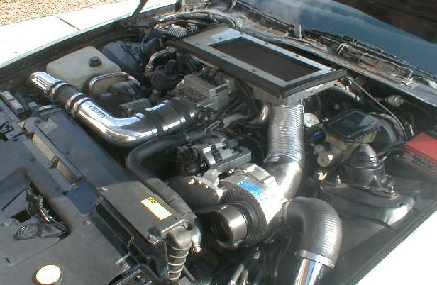

Yes, my D1SC also came with a K&N that sat right over the header. I fixed that problem with a custom-built air cleaner assembly (it houses a Corvette TPI filter) and a cowl induction hood. Some things have changed since the attached pic, but you get the idea....

Hey Willie, you don't happen to remember what kind of air temp. differences you saw by just changing where the air filter is located do you? Also, did you notice if the was any loss in boost with that setup? I heard that centrifugal superchargers are very sensitive to any inlet restriction.
I did not have my gauges installed prior to my current airbox, so I do not know the difference in temperature. I can only imagine though, considering the air filter used to sit right over the header....
I experienced no loss in boost. Consider that all I did was extend the 4-inch ATI rubber hose and replaced the cone-style K&N (763 cfm) with a rectangular piece (768 cfm).
