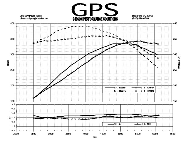

There was a comparison done with a superram versus a LT-1 intake, I would love to find the cam used in this test. Here is the chassis dyno sheet:

I run a 385. Peak power at 5750rpm. My base, runners, and plenum are hogged out pretty good too.
I have never seen any SR motor peak power beyond 5800rpm, any cubic inch or any head combo, the manifold just pukes up beyond that rpm level.
I am not saying that the cam wont work out real nice for you its just that I have never seen a SR combo that hauled with a big duration spread between intkae and exhaust.
I actually plan to ditch my cam for a single pattern solid roller.
Here is all the info you need about that dyno chart you got there.
http://www.popularhotrodding.com/tech/0803phr_beast/

thanks that helped a bunch: I had no idea that stealth rams sucked so badly. I don't feel so bad now.
car from article superram #'s:
cam: Comp Cam 12-404-4 222/226, 494/.494, 114 LSA
1/4 mile: 1/4.....12.947 MPH.....108.14
DISPLACEMENT 379 Cubic Inches
dyno #s: 335 rear-wheel HP and 392 rear-wheel TQ
Tuning: "dyno runs reflect a fair amount of wide band dyno tuning"
wieght: 3750 #
My car #'s:
cam: Crane 119681 240/248, .595.595 114
1/4 mile: 13.637 @ 99.82 @ 6000 feet (corrected = 12.825@105.44)
dyno #s: 287 rear-wheel HP and 379 rear-wheel TQ
Tuning:
dyno day- I was running the stock $8d (AUJP) bin
track day- I had done some low RPM tuning and this was my first day of PE tuning only got 3 runs.
weight: 3750

I really want to see this thing work out for you.
I took a look at CC site and it sucks that the 224/230 is cut on a 110 lsa.
I dyno tuned my combo, it really is the icing on the cake, I picked up 35rwhp and 90rwtq by dialing in the fuel and spark on the dyno.
Right now she is trapping 113.5mph at 1300 feet. I know there is more to be had and there is power being left on the table as I am running the stock 48mm TB.
You can order a custom grind through Summit as long as you first get the specs from CC, kinda a backdoor thing but the pricing is the same. Pretty fast turnaround time also.

Originally posted by B4Ctom1
So I have decided to give the B4C over to my wife as a driver. But there is no way in the world she needs a 412, so I have taken the L98 out of the 91 as part of the normal course of turning that car into a drag car. It will be freshened up, keep the accel super ram, get a set of L98 aluminums (bumping compression to 10.25:1), and get either a zz4 or LT4 hotcam. Hell there is a good chance it might make the car faster than it was with the mismatched 412 combo. I figure once the B4C is her's I will basically not do anything with it not even drive or race it.
L98 shortblock freshened
ZZ4 cam
L98 alum vette heads (10.3:1)
stock TPI lower
staying with the car for the new motor will be:
1.6 rockers
Accel Superram upper
1 3/4 SLP headers
