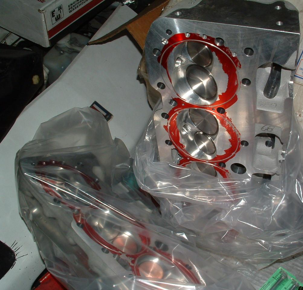

Old Mar 14, 2004 | 01:22 PM
89JYturbo's Avatar
Joined: Dec 2003
Posts: 829
From: SE PA, USA
Car: 89 Camaro IROC-Z
Engine: Intercooled Twin Turbo LQ4
Transmission: Tremec TKO 600
The heads pictured above appear to be o-ringed? Do those felpro gaskets have a copper ring in them to sit in this groove?

Old Mar 15, 2004 | 12:08 AM
B4Ctom1's Avatar
Veteran: Air Force
Posts: 4,991
From: Cheyenne, Wyoming
Car: 1992 B4C 1LE
How do those straight copper headgaskets work? I seen them in parts catalogs and wasn't sure if they were worth $85.
no they are reciever groove cut to fit a felpro part # 1045 The 1045 is just like a regular gasket but it has an oversized fire ring inner wire that fits into the machined reciever groove. the wire is made from stainless steel. If your machine shop has never done this before, find a new machine shop. the gaskets are available from vendors of felpro high performance gaskets. They are not officially O-ring. O-ring would be the next step for me and involves some compromises of its own.
O-ringing is described well above in 614Streets post with the copper gasket. The copper gasket is not used on its own to achieve the fire ring seal but is pretty much the most severe setup there is. Most cars that run O-ringing are either ford or have found it is the only thing that works in thier massive cylinder pressure application.
