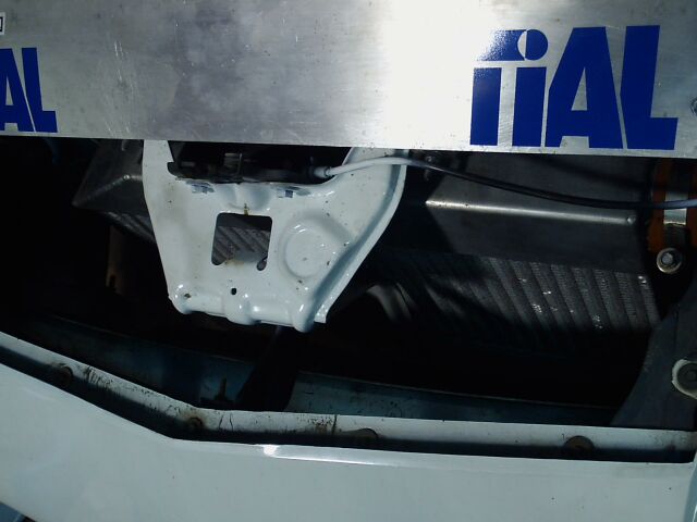

Matt I dont know if you forgot but if you could get me some dimentions on your intercooler and do you think I should use the same size, smaller, or bigger. By the way those turbos look like a pritty good upgrade to the old ones

sorry the core measures 24x9x3
from jims coolers now add 3 inch tanks on top and then on bottom
That cooler should handle 1000hp One guy is using it on his twin c4 vette making 850rwhp. You could go with a smaller one, you can get the ATI 3 cores pretty cheap and will work fine. Take a look on ls1tech.com and search FMIC there are several fairly cheap coolers being used on that site. I paid $800 for mine but it is pretty big
Yes Matt I know where Williamsport is some of my friends go to school there. As for the engine management I have a FAST wide band ecm and the turbos are rated at 850hp each I was going to go with two precsion sc-61 but Joze at forcedinduction convinced me to go with the two T-70 he sells both and said the T-70 has a lighter wheel so it will actualy spool just as well as the smaller sc-61. The motor is the last step it will be a dart little M 400ish with good parts and AFR 220 heads nothing to fancy, woops I mean AFR 210 the 220 are not a direct bolt up head. Should of found me last summer I could of taken you for a ride in the old t3 setup even with a stock L98 that thing was very fast on the highway at just 7 pounds trapped 112mph but only got a 5 runs in hot july weather with no tune.
