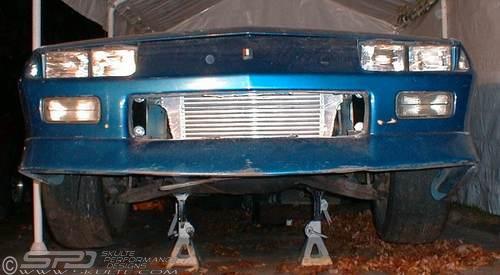

I finally put the IC fabrication pictures from 2001 up in the Z28tt gallery at: http://www.skulte.com/gallery/view_a...umName=album02
Since then, I've added a shroud to force the incoming air to go through the IC and radiator. This actually forced too much air under the hood, and got the front end floaty at Watkins Glen, which prompted me to give the air an escape route by making the hood louvers functional.

any pictures of what you did for the shroud?

Some pictures here:
https://www.thirdgen.org/techbb2/sho...=&pagenumber=1
+1 Ive gone the front mount route and still have problems with getting air to the IC and radiator.

This is how I have mine mounted and I have no problems getting air to either.
https://www.thirdgen.org/techbb2/sho...hreadid=296407
