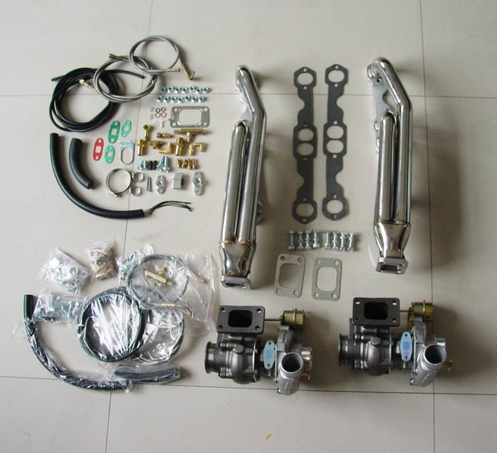

The pictures in this thread show the collectors falling apart, right near the turbo flange, from the thin metal, fatigue from the weight of the turbo and the heat.

"Assuming they’re welded correctly" this they are not, they have a bad tendancy to crack at the welds or up the primary pipes. There's been a few cases of this on my Altima forum and I found a few on the Honda forum when I was researching these guys.

For you guys bashing the SS Auto chrome and all the other knock off china stuff.
I was in the same boat on WTF it cant be that good. Buz I can't even buy the SS material to make the same setup for what they charge.
Well I can fab stuff just find. Ive done a few turbo setups and decides WTF and bought some of the china headers to see the quality 1st hand and myself etc..
Well they just got here today and the WELDS look good. They have pleanty of penitration. They ahre nice heavy duty flanges. They are nice bends,etc..
for the price You can't go wrong. As with ANY TURBO HEADERS. I dont care if they are USA made China made or made by GOD himself. anything will need soe support for the turbos unless they are log style and the turbos are poped right on top like the banks manifolds.
As for fitment. Pic's have been posted of a few thrdgens running them. Im gonna fit em up in the next couple weeks on a junk motor in my chassis and picture it all etc....

On my 240 I have an ebay manifold, turbo outlet and downpipe. And you know what. it's all exactly the same stuff as what they sell locally for 3x the price. I seriously think they make it in the same factory as all the brand name stuff, and they just don't stick the nameplate on it and that's it. I even got my hands on a brand name downpipe and put the two side by side and couldn't tell the difference.
Now I'm no expert when it comes to telling a good weld from a bad one, so I took it to the boys at work (metal fabrication shop) and they were all amazed. They said the welds could stand to be a bit bigger (as in more rod) but aside from that, spectacular.
Ya they use a thin rod but you deff. have good penetration on these few sets I got.
Whats going on is some company here in the US buys something they like. Ship it to china and have it reproduced cheaper. Material and labor is way cheaper over seas. Why do you think more then 50% of major cops here more to over seas or Mexico.
I bought these straight from the manufacture over in china so If they were junk I still got em cheaper then the people selling em on ebay.
