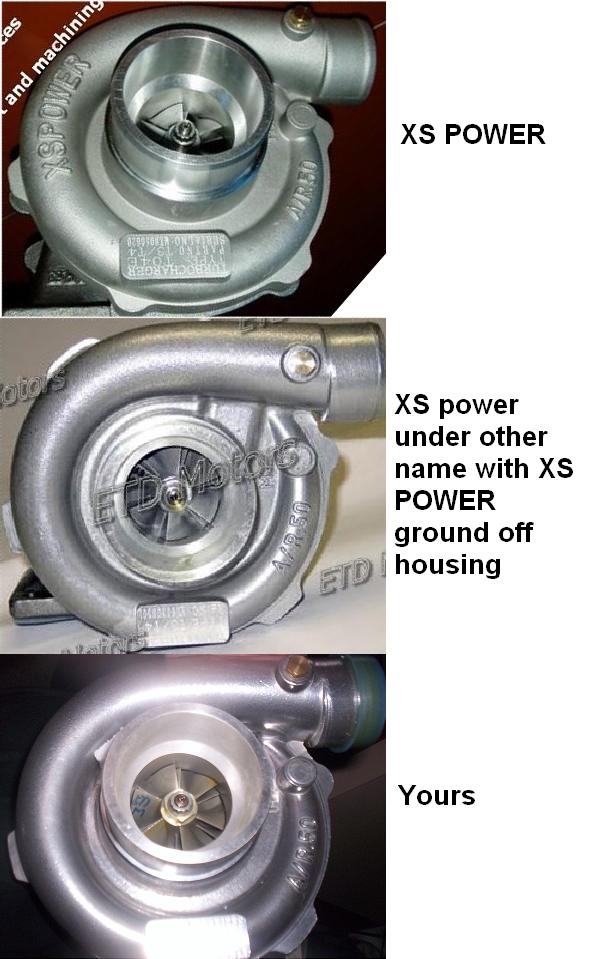

One of the ways is by changing their name over and over. The names in my thread title are among their scammy names. Turbo Zy is the newest one. I have heard a couple other not even listed above.
The same turbo in the famous "cold side glued together" picture has XSpower on it, but I have recently seen their new line of turbos with the identical makeup (minus the glue?) with the name "Turbo ZY" on them.
It is worse than that because they sell a few others which are even less descript. These others have no such trade name on them, they even switched from the riveted metal black tag on the outlet (which can still be found on the Turbo ZY units) to the blue tag on the front, in this new incarnation of turbos.
They name change game has been used well over the years to push junk, and dodge liability.

89, can you get a better pic of this "wedge". I have a turbonetics turbo center section here that I don't see anything other than a machined hole.
I'm going to dig out my Hugh MacInnes book soon, but haven't had a chance to yet.
I don't have a better picture, but see page 25 in MacInnes book. There is a picture, as well as some very good text to explain the issue.
The wedge is similar to the grooves you would see in the upper halves of crankshaft main bearings, except it tapers smoothly to force the oil through the oil holes in the bearings.
So kinda like a lead in groove in a crank shaft?

Very similar, except it tapers out to both sides, not just in the direction of shaft rotation. Also, its function is far more critical for proper turbo lubrication than the the lead-in-groove is for the engine's main bearings.
Ok, so it is what I would refer to as an oil groove, it's there on the center section, it also goes 360*, and intersects another oiling oriface 180* from the top one.
