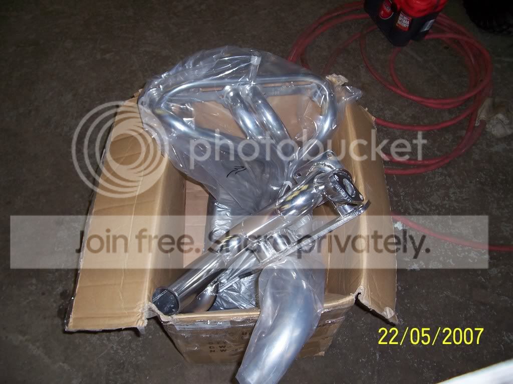

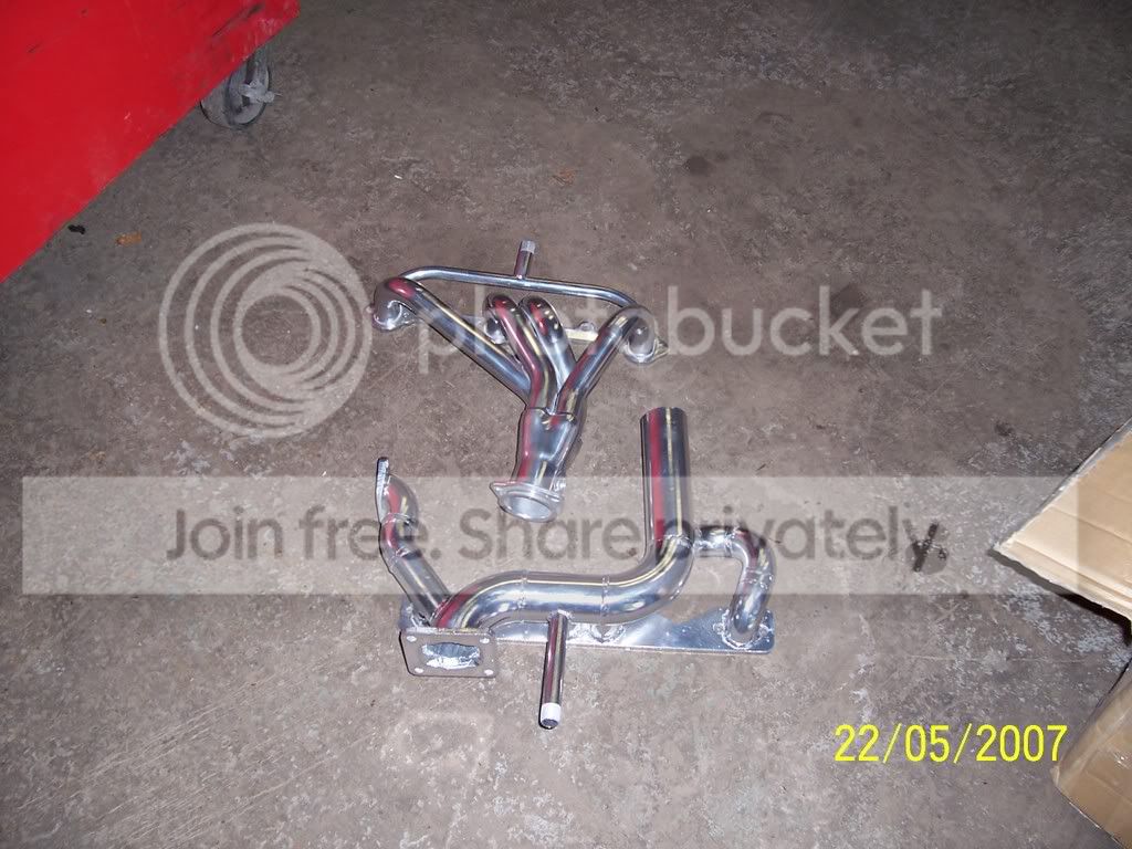

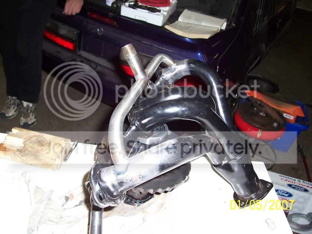

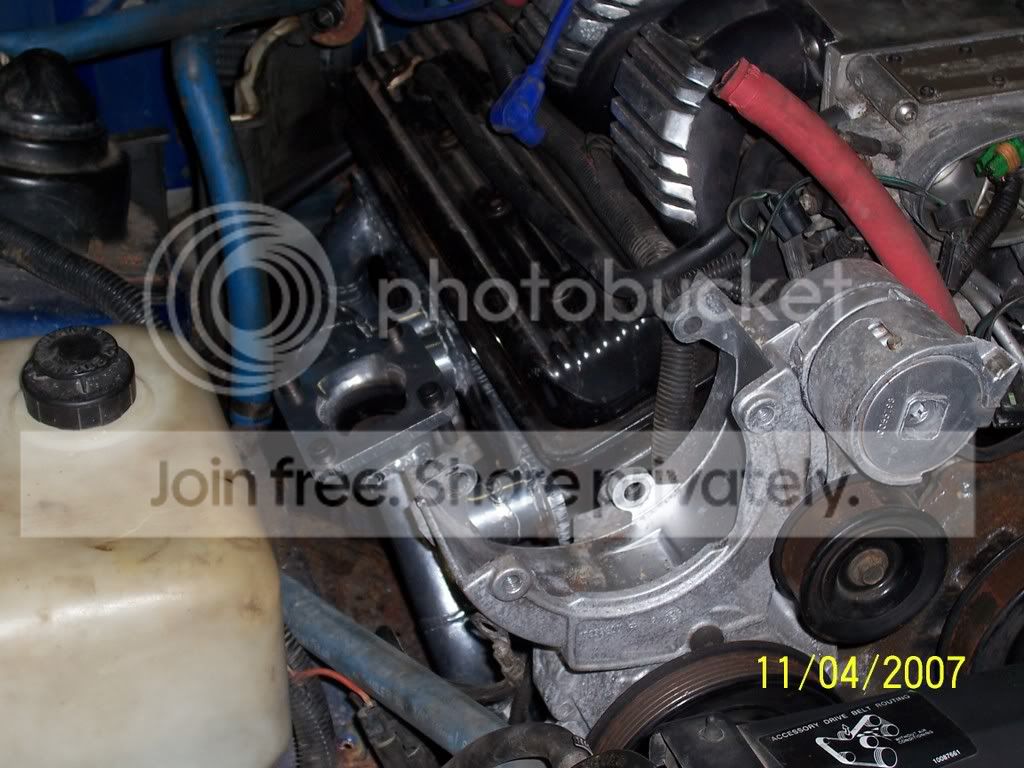

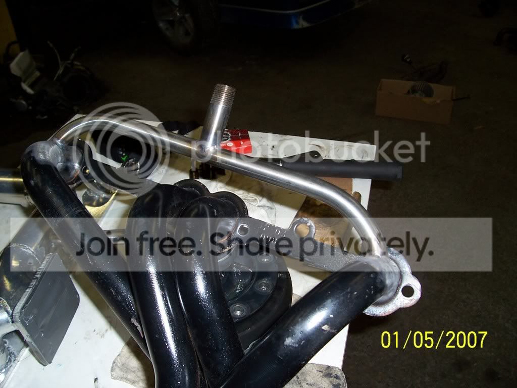

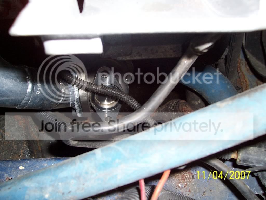

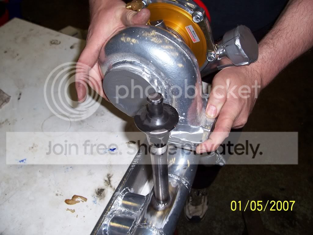

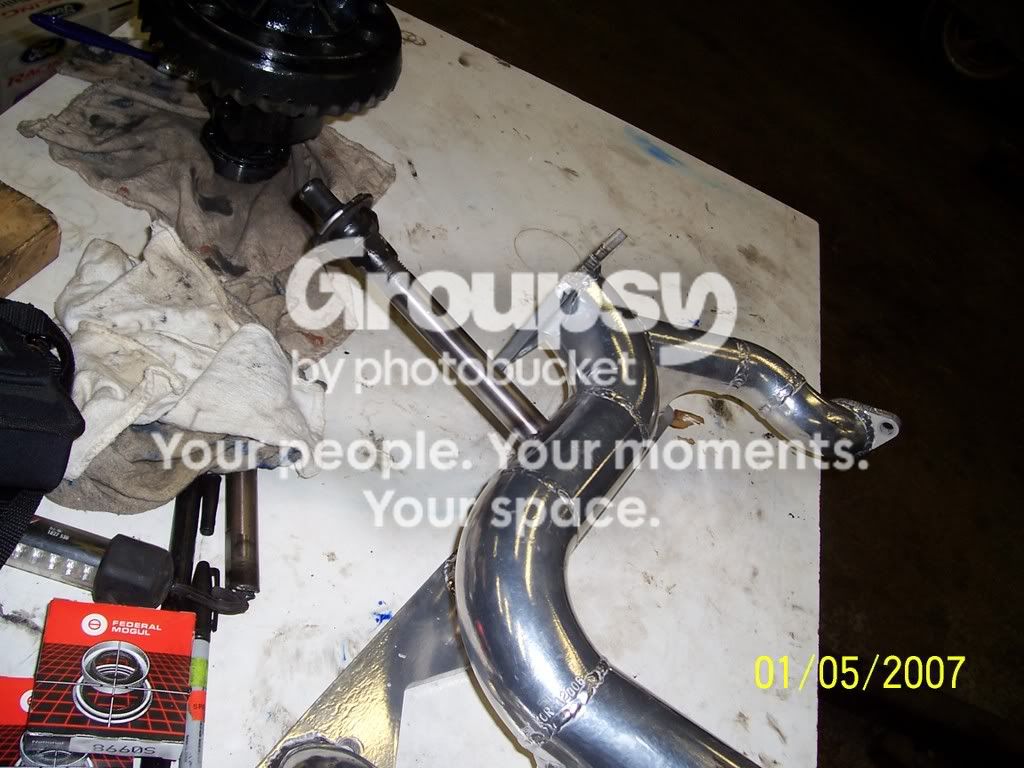

Here are a few pics of the progress on the turbo install.

u have the wastegate on backwards, the flange with the valve seat should be the side bolted to the headers.

Re: my turbo install pics
X2...
Good eye, Dave! I didn't even notice until you pointed it out and I scrolled back up, lol.
Originally Posted by firstfirebird
Hey D's, is that an ebay kit?
Looks like a BBS single.
Looking nice, shame had you had to add that AIR junk in there (how are you going to run the pump and diverter?) That is AIR stuff right?

yeah I know the wastegate was on backwards . We were just trying to see if I really needed to relocate the wastegate . Yeah I wasn't happy gettign the smogg stuff put on either . It's just that they are gettign pretty crazy up here with the emmissions roadblocks ,etc .
It started life as a single BBS race turbo kit ( 650 hp ) ...and here we are now ..with the smogg crap on it . As far as what I am doing with the diverter and all that . It is staying in all the stock locations. I have no idea what to expect from all that really. I amstarting out with a 4 lb spring ( 9.7:1 c/r )
I appreciate all the comments mates . Please post up possible issues you think i may run into with anything ( greatly appreciated) . I will post up more when it progresses. I am trying to find an intercooler aswell . I have been trying to look at everyones on here . A few look really good. But nobody reply's to my PM's
