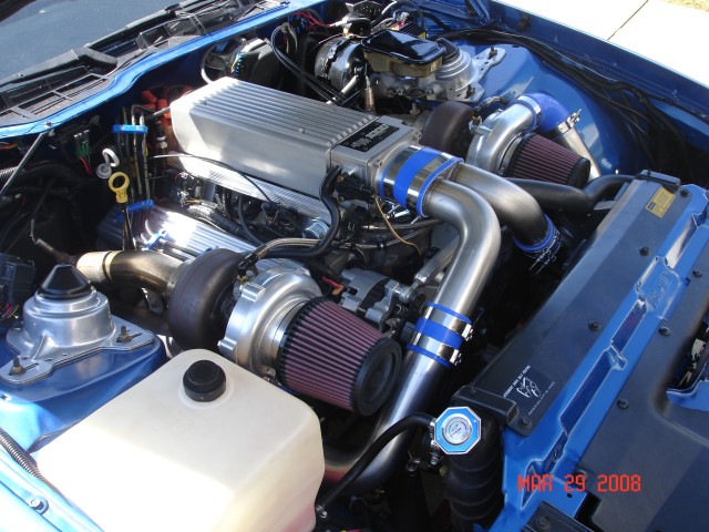

Here is the cold side. No it's not intercooled. I am going to plumb up a water injection kit for now. I am only going to be running 7psi and I am sure I will be ok. The piping is out of stainless because it was readilly available to me.

Nice clean set-up

No intercooler?

Nope, go up a couple posts.
I am also going to try to run E85.
