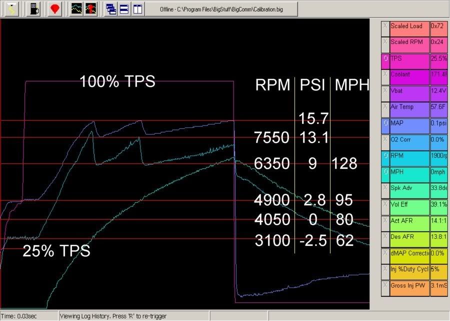

It's really hard to tell from the video, but at idle you'll still be pulling vacuum, and if you listen closely to part throttle you'll see the boost immediately hit 5-psi, then work it's way up at WOT, Click Here....

You won't see any boost at part throttle and normal driving conditions. The boost builds based on load AND engine RPM.

This part I kind of disagree with, as load and RPM is prevalent even in part throttle conditions, even moreso from a dig, not to mention the size of the pulley utilized also being part of the equation. I'll try to get a short clip of my cousin's Corvette at half, and/or part throttle. The needle obviously isn't pegged anywhere near 10-psi, but it's definitely passed 0-inches....

You're not going to see boost at only 25% throttle with any blower setup. My roots blower doesn't go into positive boost until about 75% throttle. The few centrifugal setups I've worked with are similar (although boost builds with RPM, even wide open).
The blower has to outrun what the engine is natrually capable of swallowing before the air starts to back up in the intake manifold (which what boost is- a by-product of excess airflow).

Oh really, then explain the buildup of boost being released by the blow off valve with just the blip of the throttle while idling in Park, Click Here....

^ Courtesy of KenneBell.net....;
"Having 5-psi at part throttle makes for a seriously fun car to drive. Those 5-psi part throttle stabs will be used 100 times more than the full throttle rips up to redline, especially on a serious motor"....

No boost IN THE INTAKE MANIFOLD, chief. That's where you measure boost becuase that's what the motor sees. Hard to make any boost on the far side of a closed throttle plate.

You probably won't see any boost or very little under normal driving conditions. To have boost like that out of a supercharger you need to be running a screw or roots type.

That's not what you initially said, you said "you're not going to see boost at only 25% throttle with any blower setup". Now, considering the fact that boost gauges are meant to read vacuum/boost from a full intake manifold vacuum port, where else would the guys over at Muscle Mustangs & Fast Fords be reading 5-psi at part throttle on a constant basis? If it wasn't making 5-psi in the intake manifold, they wouldn't get a 5-psi reading on the gauge. As for the video clip, that's just to show that unlike a turbocharger, boost is instantaneous with a supercharger, as it's not so easy to get the BOV to vent in Park with a turbo....

Re: blow off valve not closing? wtf?
Granted I'm running a D-1SC, but here's a datalog of one of my 1/4-mile passes. Pretty clear to see that it makes more boost with more rpm and load.
http://i50.photobucket.com/albums/f3...2z/DataLog.jpg
Originally Posted by 8T9 Bandit
a freind of mine had a t-bird sc. it made instant boost thrue the rpm range.
^ Exactly, unlike turbo chargers which rely heavily on engine load, supercharger's really don't care if there is a load per se, as they increase with RPM either way because they are belt driven, and are constant....
I don't know much about chargers, turbos, etc. But in the picture you posted that was of a surge valve. I thougth those were to release excess pressure in the system and not act like a blow off valve where those release pressure upon shifting. Just my thought... Only 7psi? That seems low most people i hear of try to run at least 12psi.
Old Oct 14, 2008 | 10:55 AM
Street Lethal's Avatar
iTrader: (16)
Joined: Jul 2003
Posts: 10,538
Likes: 206
From: NYC / Jersey
Car: 1990 Trans Am GTA
Engine: Turbo 305 w/MS2
The bypass valve and blow off valve are the same in principle, only the blow off valve vents the excess air to the atmosphere, while the bypass valve keeps the calculated excess air in the stream....
so would the bosch valve give me better boost through the curve?
^ Forget the Bosch, and get a nice sounding atmospheric BOV valve. The rumor of running excessively rich with a MAF sensor is really a non-issue. The ECM sees when the throttle is closed, and if still over a certain RPM, the injectors shut off anyway until dropped below the targeted RPM....
