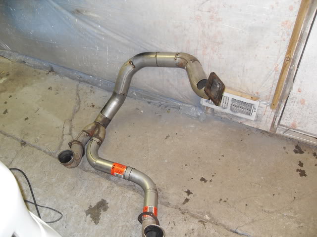

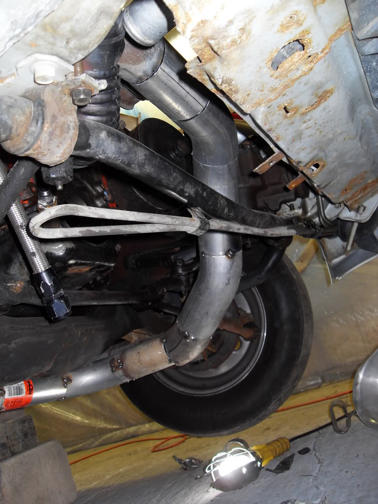

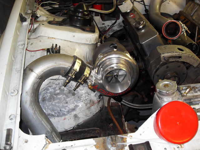

some partially fabbed hotside pics, and few others
Old Feb 3, 2009 | 03:30 PM
5literTPIterror's Avatar
Joined: Nov 2003
Posts: 315
From: upstate new york
Car: 91 camaro rs
Engine: 355, blowthru, 78mm turbo
Transmission: th350, art carr converter
Axle/Gears: stock 7.5, 3.23s, minispool

im using a Turbonetics TC-78(.96 a/r t4), on a 355.
50mm jgs wg
56mm jgs bov
1 3/4" f-body hooker headers
2 1/2" crossover
3" to turbine
afr195cc heads
vic jr.
csu 750
comp cams hyd roller around .575" 224 duration
aeromtive fuel system w/ A1000
msd 6al btm and msd pro billet dist.
th350
3800ish stall
3.23s w/ mini spool for now
looking to make 650-700 crank hp, seeing 80+% street use, hope to run 10.99@130 on 15-18psi (3500lbs)

Nice, I like how it's all mandrel bent tubing and the way you used standard facing headers. Do you have your downpipe fabricated yet? Also, have you thought about moving the air dam forward so that it's flush with the front of the intercooler? It looks like it would direct the incoming air better that way.

Re: some partially fabbed hotside pics, and few others
i have not had any real issues with overheating yet with the intercooler like that but i think i will move it forward a little bit to allow air up into the radiator also. we'll see ive only got about 20-30miles on the car with the "old" turbo setup...

Looks good! Where are you going to run that downpipe and what size?
im going to make a half circle notch in the firewall behind the passneger side header collector. and its going to be 3 1/2", i'll probably use a single 3 1/2" bullet muffler right about where the factory cat was and then head towards the rear along the driveshaft and most likely dump it at the axle. that the plan anyways..
Looks good. I want your turbo! Want to trade, mines good for 10.7's. haha j/k. Nice work. As far as the airdam goes, mines in the stock location and my intercooler is exactly where yours is and it works fine. When i make a pass, i can feel one side of the intercooler is hot and the other is cold, so air flows thro for sure.
