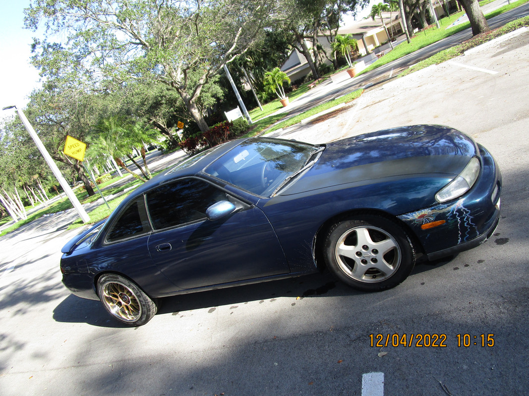

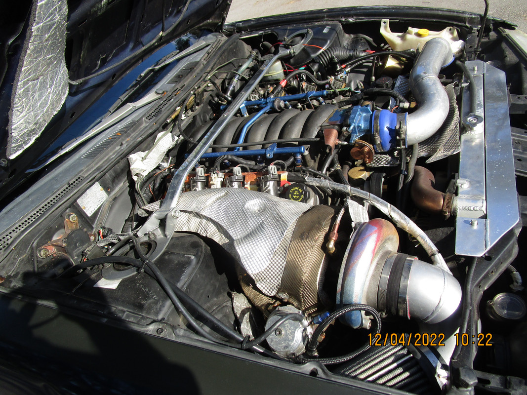

I use LS engines these days. They are basically free here. Here is what I run in my daily, using a free high mileage 5.3 from a local scrap
Build thread in sig for process

1. Cleanliness is the most important thing keep the oil clean, dont touch parts with bare skin like cam lobes or spark plugs, dont leave the engine open for long in the air, pretend its a surgery patient
2. follow service manual and keep parts like factory specifcation
3. You must pressure test from compressor cover through intake manifold (video how to diy in my channel linked from build thread)
4. Evacuate the crankcase using turbo inlet like my picture shows, do not use any catch cans.
5. Replace OEM CHevrolet PCV valve with a Toyota Supra twin turbo 1995-1998 PCV valve because the Chevy pcv will leak boost into the crankcase
You should read my build because I put the other 99 tips in there for how I do everything
Headgasket thickness is practically negligible with respect compression and the downside of a large gap often outweighs the upside of slightly reduced compression so I would go with the tighter thinner head gasket on most engines.

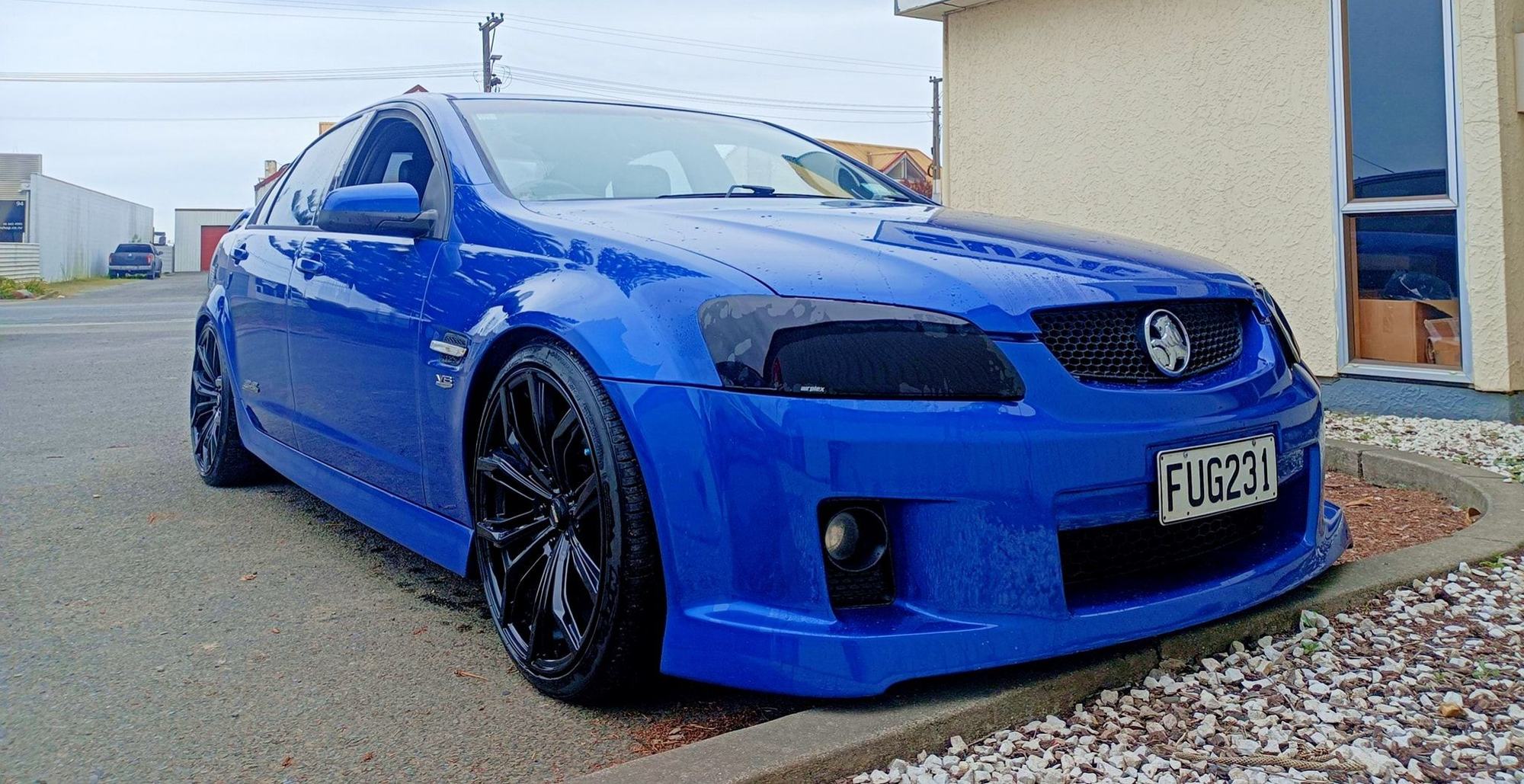

just flicked through it now. might get right into that thread real soon!. some of its way over my head but i can see how alot of its going to help.
thank you for replying to a 20year old thread to help me
​​​​​​​picture of my car im turboing

That thing looks newer. I am surprised you don't use a modern turbo 2L or 3L engine it would make similar power and be lighter and more simple to work on?
The only reason I went 5.3L LS was because they are free engines around here.
If I had a dime I would have used a 2L or 3L Nissan/Toyota inline sr20det/2jz-gte

its a 2007 holden commadore from australia, i think in America its called a pontiac g8
its my weekend car that i take the kids out in, cammed, loud.. and now i want a turbo on it haha.

I absolutely LOVE this swap!
First off, I really miss many of the Coupes that Japan had here, and the 240sx was great!
Second, that Engine Swap is so unexpected that it has a great Sleeper aspect to it!!
Third, if the exhaust on the car is relatively quiet, it would fool and destroy so many stuck-up Jerks with their newly purchased $100,000 whatever Sports-Car!!!
That looks like way too much fun! ...I hope it has a T56 in it!
