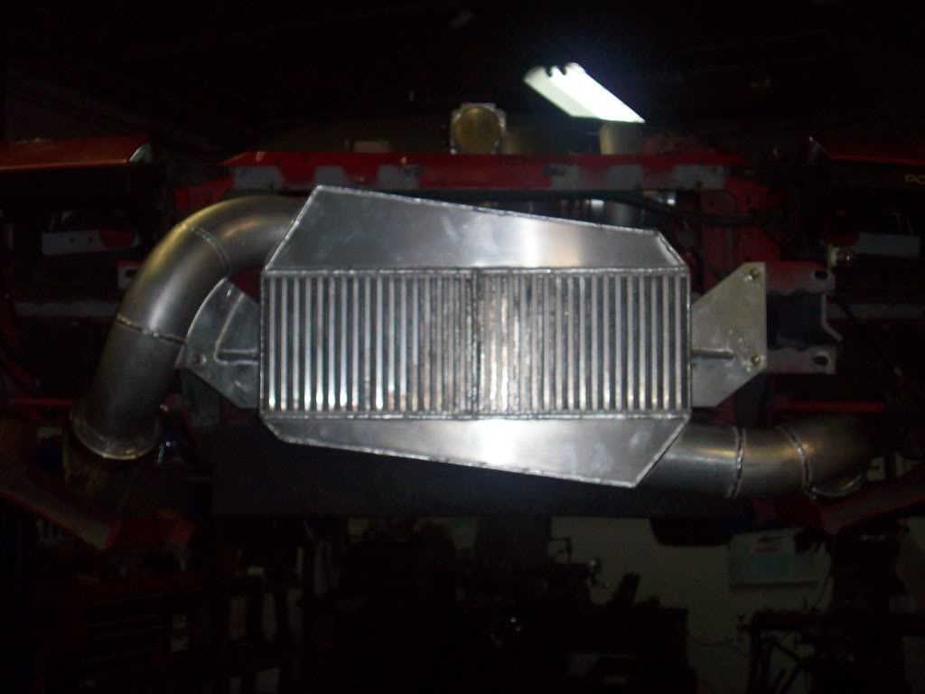

Re: Firebird Intercooler
Heres mine its 31x12x3. I had to do a lot of trimming with the front impact bar. I switched it to the correct 91-92 air dam last year with a Taurus fan and it cools fine now. I may add a custom air dam if it decides to run hot this year, but it shouldnt now that I have an appropriate sized exhaust.
