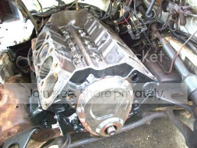

If you're gonna use a stock TPI intake what are you gonna use for an ECM?
Go "165 6E" please please please.... ;P

This just keeps getting better! Love the twin 49's idea and the TPI. This should be a very interesting build. On the budget, go 730 ecm and Code $59
Only thing i'm worried about is if those are a true 49mm compressor wheel, you may not have the air flow capability to push the 650-700hp needed to get into the 9's. Something inthe mid 50's would be abit better.

You mean TA49s? That is a ton of turbo for a 305. Should move. :P The TPI makes me want to see what this does even more now. Glad to see you did a real fuel pump though out of anything that will help the engine live that would be it I would think

A TA49 isn't 49mm. It's 58mm. Quite honestly I don't know why thye are called a "49" now that I say it but that's a tangent. http://www.nolimitmotorsport.com/pre...ck-turbos.html check the chart here I think a stocker is bigger than 49mm tbh. I see big power in your future
What injectors are you getting I'd do at least the FMS 42s if not a set of 60s. I got some 39s for mine am afraid they're not going to be enough but for $100 shipped I can sell em and replace em again if need be.

Ok if they are a 58 thats a good bit of turbo for twins on a 305. Should easily support the power. Probably will need to start with 60lb injectors for the 9 second power if it holds that much. 42's on high lsx pressure can support good power as well and may be better suited for a 305. 60's are nice injectors tho.
As far as scanmaster goes, i have no idea if they works with code 59 or not. I just use tunerpro RT and datalog with that.

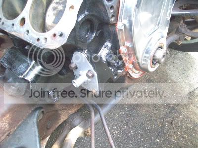

I am trying to keep up with the changes.
305 bored 30 over, stock crank, stock rods
ported 416 305 heads (with maybe some EGR welding)
stock late-70s truck manifolds (with some bronze brace on them, will that really hold for 9s?)
BTW, those manifolds will struggle to flow 500BHP
TPI intake, stock TB?
BIG fuel pump
twin 58mm turbos (plenty of top end, will it spool in first and second below 4000 RPM?)
That is definitely a mix of parts to get into the 9s. Still watching and hoping you get it done. Before it is run it will be fun to see the final product and do some ET predictions.
Great job so far.

You really think the manis will be a problem? I'd think they would do it but it's likely what I get for thinking. If they're 350 truck they should be "decent." At least compared to the stockers.

The bigger the header tube (or port for manifold) EDIT: TO A POINT will allow faster spooling and more charge to the turbine. This also frees up some HP to help the exhaust flow better. So it's worth some power to use them. I on the other hand, have never had a turbo V8... and talking about this is making me miss the turbo cars I had (especially the DSM with the extended Ford warranty)...
back to topic...
How much would some low (er) buck SBC shorty turbo headers run?

Originally Posted by Street Lethal
Also want to clean the threads in the block with a tap to get the proper torque reading, clean everything up some, then hit it with some High Temp Black....
I wouldn't put a tap into the holes. It will mess up the threads and you need them as good as new for the boost you are going to run. I would get the proper thread chaser.
Had a minor setback with a broken bolt that I found in the crank snout which turned out to be hardened steel. Have no idea what the former owner was thinking, as it looks like it once was part of a harmonic balancer puller (you can see the shavings on the floor in the pic). Took awhile to get out, but it's finally out, as well as the stock camshaft and lifters. The cam I ordered for the 305 just got here, its a 224/230 on a 114 LSA. Still need to clean up the engine, but the next post will have the cylinder heads bolted up, as well as the engine looking a little more presentable. Should have it ready in about a day or two.....
Man, that is a lot of work to do with the engine still in there. Cam choice seems good for the TPI and ported heads. I hope it was a cheapie $50 one or free.
Its just a common hydraulic flat tappet that wasn't too expensive. I really wanted to try the 218/218 Lunati cam that I have, mainly because of Marty's build over on the turbo forums. He was running a stock bottom ended 350 out of a truck, with the stock 1.72 heads, and 268 cam (which is also a 218/218). My Lunati cam has more lift, and I'm running much larger valves, and it would have been interesting to see if I could have run similar times with the 305, but with more boost of course. Not much to update just yet, as the head gaskets were of course the wrong size so they were shipped back, and the Mr. Gasket timing cover didn't come with a timing tab so now I am waiting for that little piece before I put the balancer and water pump back on. The cam is in though, as well as the comp cam lifters. The oil return fitting, although looks small in the pic, is actually larger than -8 AN after we drilled it out, and will not be a restriction whatsoever. I have another oil pan that I will be using, and the second oil return fitting will be welded into it...
Nah, Marty was running the Summit Special 224/224 on 114. He was running a 350ci with TH400 and a close to 100 HP N2O shot at the end to hit 9s.
Comparing his setup to your setup (small cubes, equiv. intakes, no N20, almost same cam, etc). You can't leave hard on your trans and rear. I give you credit for building a fun project, but it is going to take a better trans and a decent shot of N20 to get 9s with the parts you installed.
