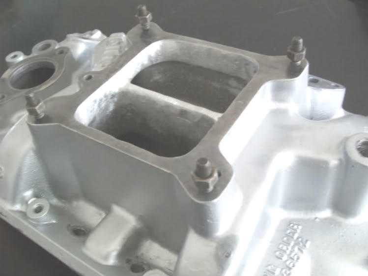

Thanks. I'm going to retain the White/Blue look of the anniversary style on the exterior, so I hit the runners with the same blue as the injectors to go along with the scheme under the hood, and then I clear coated them. Also went with a blue BBK afpr, just waiting for it to get here and then I'll throw it on....

The head gaskets were brought down to a torque value of 75 foot pounds, but once I got some heat into them I would have gone back and finalized them at 85 foot pounds. When I explained that I fixed the TPI intake to cylinder head issue, this was because I decided to go with another set of heads that I had entirely (a set of 333882's 1.94/1.50). More flow on the intake side as opposed to the 416's 1.84, but compression would now be lowered even more because of the 882's 76cc, so its off to the machine shop to get compression back to 8.5:1. Throttle Body is 54mm (900-cfm). Should make over 300-FWHP w/out boost, but because of the low compression, not by that much.

Gonna show you guys an extremely cheap alternative for a blow-thru carburetor while I wait for the Holley EFI control. I have a Carter 600 AFB w/manual choke that I am going to convert so I can run the turbo right away, and will show you how easy it is to do. This isn't intended to take anything away from the professional shops that will convert the Holley's for you, because they do an excellent job, this is just for the do it yourselfer who's looking to spend under $100.00, carb included. While I get ready to start documenting it for you guys, I sanded down and painted a non-AC box that I had lying around, and am redoing its' wiring so you won't even be able to see it. Gotta have heat as well as a defogger, those who run at night at the track on the east coast know exactly what I mean....
Disregard that fugly tire and rim, I only use it to move cars back and forth lol....
