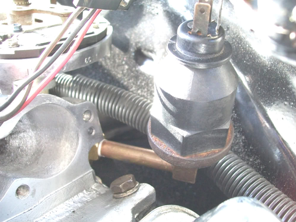

Wanted to confirm something, the stock throttle kickdown, although does in fact reach the bracket on the plenum, does not "extend" far enough to work properly, let alone even reach the mounting point on the throttle body lever. So yes, it is definitely needed when swapping from a carburetor to TPI, along with the throttle cable too....

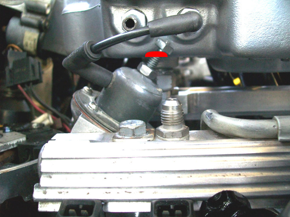

TPI "fat cap" was a mess, I cleaned it up and sorted out the wiring issue. Started to polish it, but then stopped myself because I'm going to start on other things today. Ordered a new Petronix Ignition Module because I already have their Flame Thrower coil up top, and the ignition module that came with the distributor simply can't be trusted....

1985/86 TPI came with the fat cap (it's already installed in the pics below). I had to get creative with the 1/8" NPT fittings for the oil pressure sender. I used the stock fitting in conjunction with the splitter from a few pages earlier. First picture is of course the oil pressure sensor, and the second picture shows the oil feed to the turbo....;

Looking good. Why not install the EGR and just disconnect the vacuum line or solenoid and make it not functional? That is a block off plate in itself.
You might have idle tuning problems with completely removing the bumps in front of the IAC holes in the plenum. Something to keep in mind if having tuning problems at idle compounded by large injectors.
You could grind down the adjustment nut and lock nut on the adj fuel regulator. That is what I did to gain the adjustment I needed with a short bolt.

The beauty of removing the bulky EGR housing and going with a blockoff plate is that the runners don't need to be removed when swapping injectors, just the upper plenum and throttle body. You can pull the fuel rail (once unbolted) straight towards the front, then up and out. With the EGR valve in place though, the fuel rail can't even be snaked out with out removing the runners, and I know I'll definitely be swapping injectors in and out....

You could grind down the adjustment nut and lock nut on the adj fuel regulator. That is what I did to gain the adjustment I needed with a short bolt....
I took a ride to Home Dept last night and was able to find a jamb nut about half the size of the one in the picture, which reduces the height substantially. I was also looking for a bolt with a smaller (thinner) head to it, but they had nothing. So now I might have to grind down the sides of the head of the existing hex bolt that I am using, unless I can find one elsewhere....

Okay, finally put an end to the adjustable regulator dilemma lol. As already stated, I nabbed a jamb nut about half the size of the one that I was originally using which allowed me to go with a much shorter bolt. However, I couldn't find a bolt with a smaller head, so I was forced to make one. I bought the same size thread, but just the stem, no head, and I cut it to the length that I wanted. I then "filed" down the side that I chose to be the top of it into four sides, no reason to file six sides because I can grab it with a small adjustable wrench. Now it clears no problem, I can actually remove the bolt with the plenum staying on. Note that the bolt is already hitting the spring inside the regulator in the pics, so there is plenty of room for adjustment. Now I'm just waiting on my blockoff to wrap up the engine....
