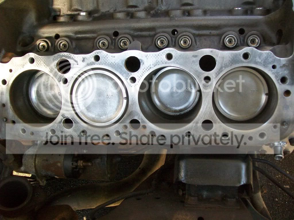

I had to pull the 416 heads. I got in touch with the guy I bought the old '84 project from, and he said that he always suspected something was wrong with one of the heads, he felt that one of them was cut down and one wasn't. I didn't even bother to check that when I did them, as I was so focused on so many other things. The engine ran fine with them, but just the idea of that made me upset. I already had a set of 187 heads that are now finished, and should flow the same as the 416's, without the worry of them being altered in any way. For peace of mind I really had to do that, plus I wanted to see how the pistons looked anyway, they look good...

Looks super clean, didn't realize you had a punched engine. Those 030 slugs have the low comp dish in em I bet that engine is 8:1 flat with 58CC heads. Don't say you're gonna start a V3 thread, start one!
