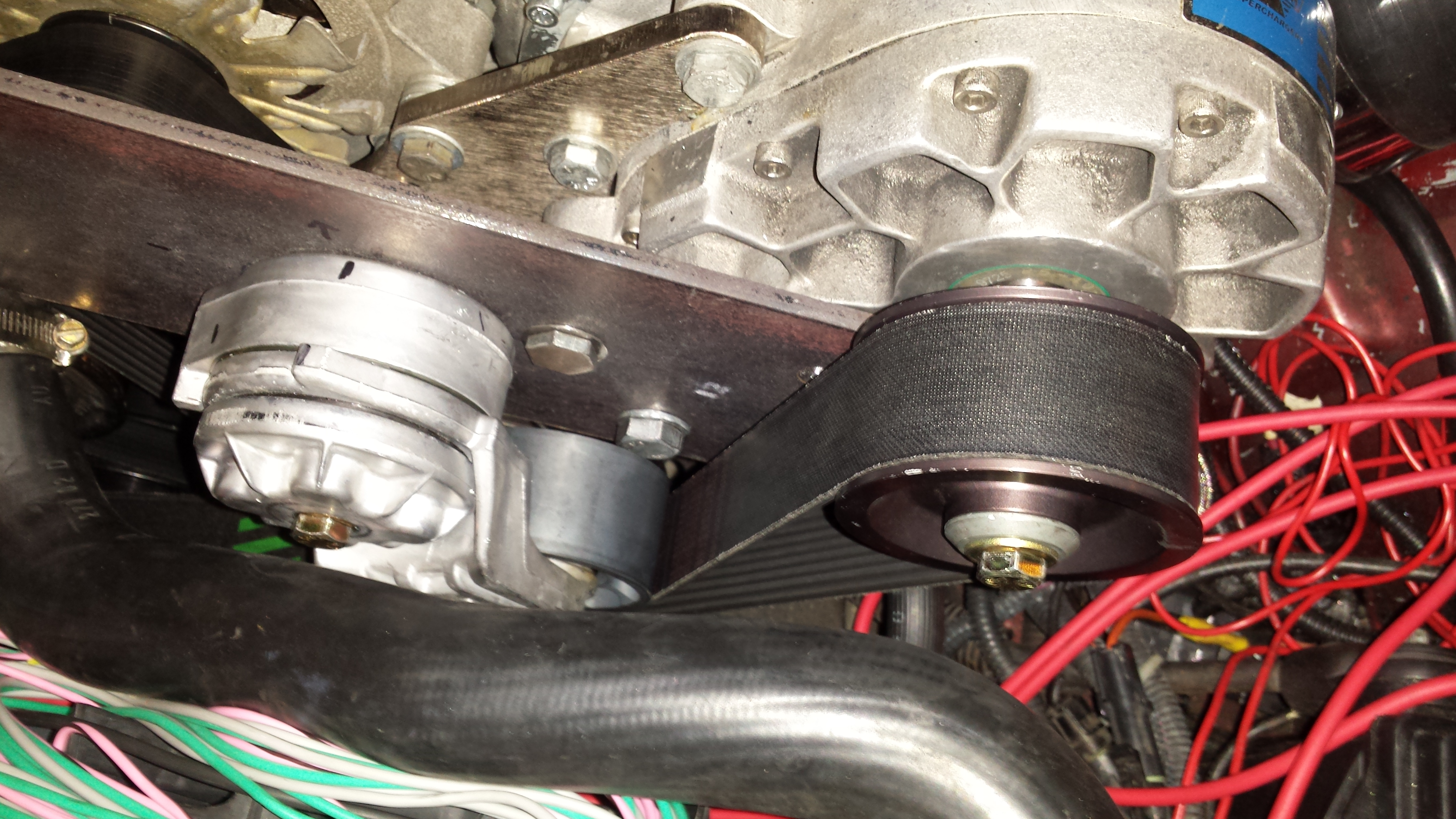

Need some help with trying to get my automatic tensioner working. I am crashing and burning at each attempt.
Bought the dayco 89401 tensioner on ebay and some plate steel from lowe's and cut the plate and drilled the holes for my blower.
After moving the tensioner location on the plate a couple of times, I have it where the belt barely gets on the blower pulley and the tensioner is about 80% open (under tension on the belt). Drove down the block to test it and only hit 8.5 lbs of boost. Stopped in parking lot to open the hood and check it out and the tensioner was locked down in the fully extended position. (starting location of the tensioner was about 3 o'clock and ending position about 5-6 o'clock).
Not sure what I am doing wrong here. I will have to start over with another piece of steel, as I put a lot of holes in this one. Ideas? I can't imagine the belt stretching that much during a run, I only took it up to 5700 rpm.
Attached Thumbnails Procharger guys need a spring tensioner, video and tensioner setup inside!-dayco-tensioner.jpg

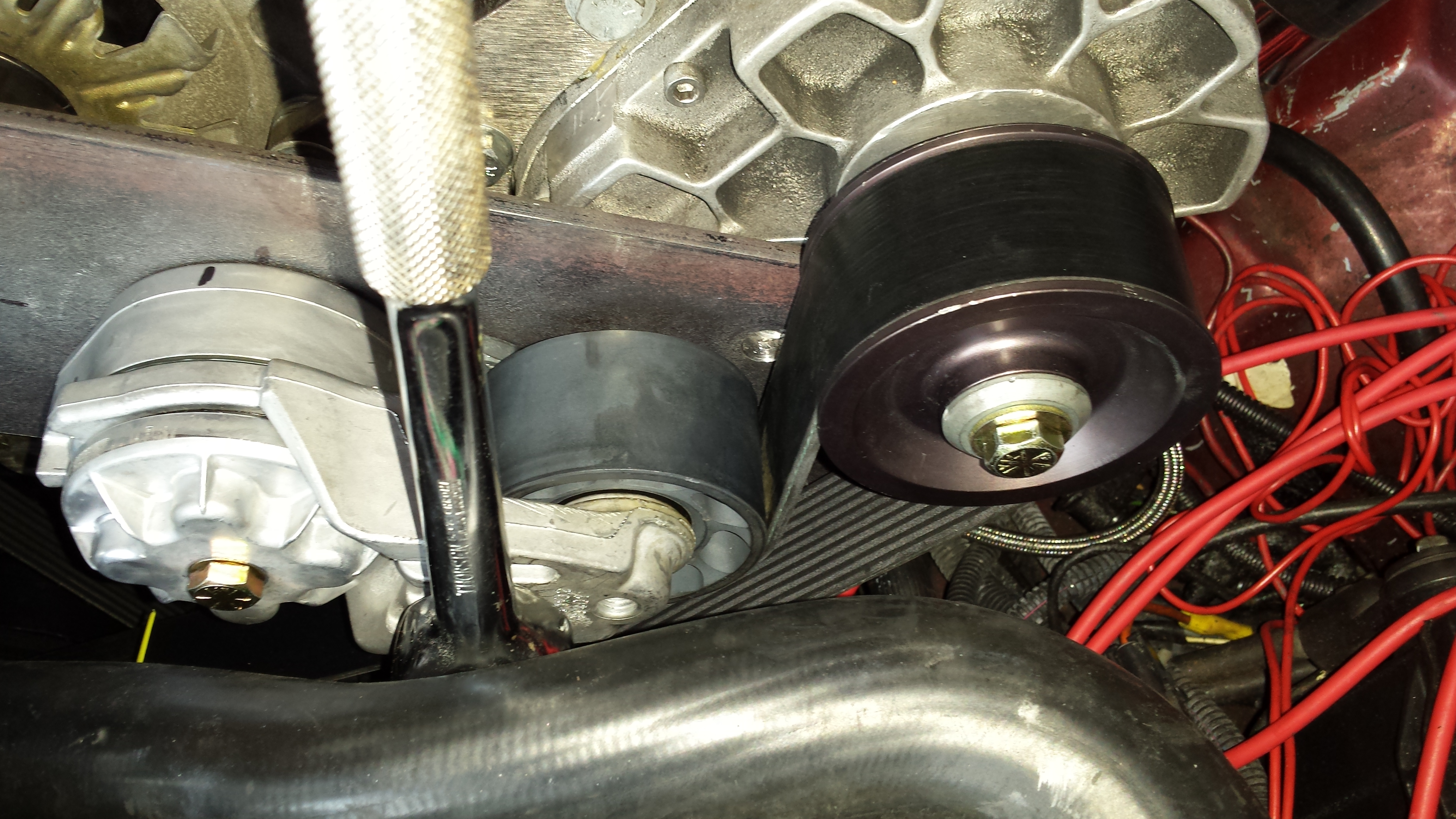

This is the tensioner after it goes full lock downward

Did you end up getting this issue figured out? Looks like to me it is locking out because of your clocking position of the tensioner. When it is stretched and goes full lock, the tensioner is just past 90degrees perpendicular to the belt , so the belt tension against the pulley is locking it forward.
Looking to do the same to mine, and want to avoid the same issue.

I could have re-positioned the tensioner again, but after doing it too many times, i had too many holes too close together. Would need to start with another piece of steel. After looking at this thread on the mustang forums, some guys over there said the tensioner needs to be on the slack side of the belt and not on the tension side:
http://forums.corral.net/forums/supe...tensioner.html
I didn't get a chance to finish it as I need to pull the motor and check the mains for excessive clearance, so it will be a while before i get back to testing it.

The top side of your pulleys is the slack side if I'm not mistaken since the crank pulley pulls your s/c pulley over from its bottom side. Isn't yours on the slack side?

What the mustang guys were saying was to use the factory manual tensioner on the top side of the belt, (like in the pic where i have the auto tensioner currently), then put the auto tensioner under neath the belt on the 'slack side' meaning the side with no tensioner on it. they are saying that 2 tensioners give you the adjustability you need to handle belt slip, the auto tensioner just takes over where the manual one can't after the belt stretches.
