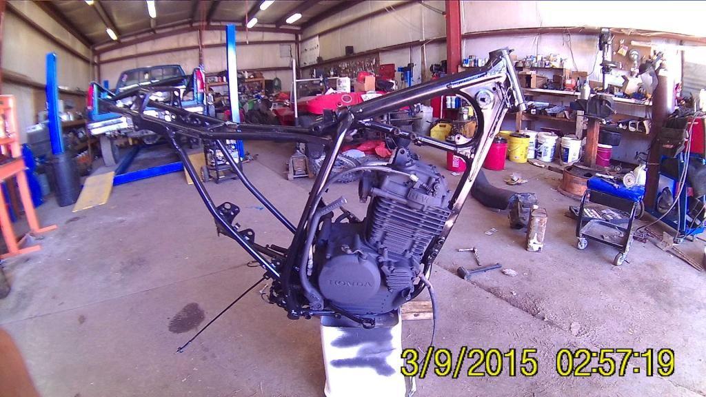

still working on the bike , its getting turbocharged just started to mock it back up today
in about 1-1.5 weeks ill get back on the car since im waiting on one more thing that needs to go threw the shop first
updated picks of the bike
frame and engine painted
mocked up with the body panels
of course i had to spray some flake on the tank
and im going to grab another set of wheels so i can have real street tires for it
other then that i have an extended polished aluminum swingarm of an xr200r comming, and swaping the rear 17" wheel for an 18", along with a set of short style smoked led blinkers
the turbo will be an rbhv31 turbo set at 14 psi , with ablow threw carb setup , if the blow threw doesnt work its getting fuel inection with a microsquirt
stock it makes 34hp/24ftlbs who knows what it will make with 14 psi
i really have way to many projects
Nice looking bike. Where did the hp number come from? It rivals newer engine technology for 250cc engines. I thought the 80s XR250 engines were around 22HP. They only revved to 9K.
That turbo is a little oversized but I think is about as small as you can get. The china ones have been known for broken shafts. You can come across a real one on ebay from time to time.
If you stick with carb, how are you removing timing? Or going E85 or other high octane? The stock CDI does not make timing mods that easy. If you go with Microsquirt you need to trigger it and the CDI is too high a voltage. If you use the VR with the stock trigger bumps (odd shaped teeth) then the VR ckt doesn't work 100% right. Anyway, are you building your own pickup ckt or gonna use a GM HEI module as a pickup and fire an inductive ignition.
I messed with this stuff before. I ended up using a motorcycle inductive ignition box to pickup the timing bumps. Then used digitial signals inside the box to trigger the ecm. This was the most reliable way to do it.
Good Luck. Fun Project!
Also, try googling EFI for motorcyle kits. There is some bolt on kits that are reasonably priced. One of those may be a better deal than piecing it together and resolves the ignition problem. We all know what a hand full carbs and boost can be. I think the bolt on EFI kit is best bang for buck.
Ecotrons boost version 34mm for $600
thanks when i got it i knew i had to o something about the paint , i did a black basecoat then mixe dup some pearl powder in the clear to get the blue pearl love the way it came out
that number comes from ever source i have looked up, even from hondas specs its also the 4 valve engine not the dual valve engine.
the tricky part is this engine used 2 carbs
its low compression so blow threw with high octane or e85 should work ok , im trying to avoid the efi , the ecotrons kit was an option but not sure how tomake it work since i would need 2 injectors and tb's
ive seen the rbhv31 used on 150/200cc stuff so should be ok and witht he amount of hp the engine makes it should have no problems spooling it
Check out the Ninja250 kit. It has a dual TB setup 28mm. The crank trigger is different so you would want to have the ECM trigger for a XR250. The ninja has 3 short teeth and 1 long tooth. Not sure what the XR250 has. You can get the kit with dual 25 lb/hr injectors. Although, most of the parts look china flimsy but may be reliable.
I think you are right about the turbo. I had an RHB4 in mind.
