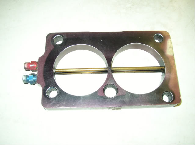

if u want to do it right take one of the tpi plates to a machine shop , and have them machine u a new plate tapped for 2 single nozzles out of aluminum
i would not stack 2 plates ontop of each other , and the single plate with 2 nozzles means u dont have to worry about tv or throttle cable etc
something like this
or add nozzle(s) to one of the plates u currently have, stage1 would be the plate and second stage could be 1 or 2 nozzles depending on how u decide to do it

Fwiw, people have been stacking cheater plates for years. The bars don't spray straight down, so there is no obstruction. Problem with a tpi/lt1 plate is the limited space to put the holes in the spraybars. (Only 2 52mm holes). My car picked up over a full second in the 1/8 with a 100 shot. 7.2 n/a, 6.10 with the 100 shot. I like the bars and nozzles in the top of the plate. Might be how I would do it.

even though theres no disturbance by stacking the plates wouldnt a plate with bars and nozzles be less of a hassle when it comes to throttle cable/tv cable etc

One plate would be simpler, for sure. another issue is distribution won't be the best with that intake. Will need to stay on your toes with the tuning.
