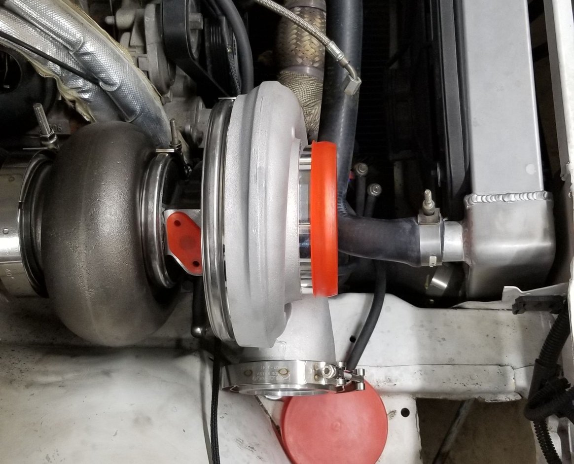

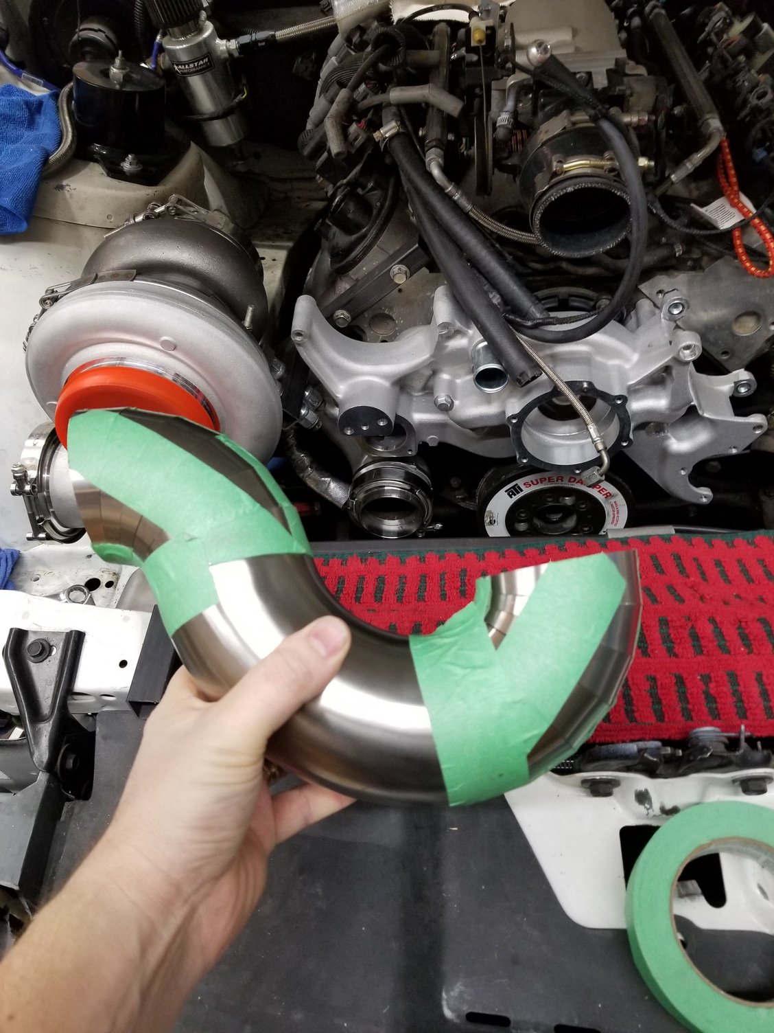

This is going to be fun! Decided I will end up mounting the turbo a bit higher (still have like 1.5" to the hood!) So the lug nut spacers are just mock up.
Going to have to build this all out of pie cuts for the most part! Yikes.
btw the accessories are the new Holley mid mounts. AC compressor fits. I'll need to make a custom billet adapter for the lines. But not a big deal.

Re: Project Déjà vu- 87 Z28 5.3L Turbo
Jay
Wow! That looks awesome, clean cuts and all! What tools you got for cutting pipe? Mine never come out that clean lol.
Mid mount holley system looks good as well, I thought about it but they are $$ and you have to use there stuff right (like alt, PS pump etc)? I like that the pump uses a cartridge as you can just swap it out when it fails vs having to get a whole new housing etc.
hahah I cheated, bought the pie cuts from Bend Brothers. Super good pricing. I think it was $22 for 6 pie cut stainless 3" (enough to make a 90)
The holley ones are $$$ but my buddy weighed the options. He wanted AC and the only way to do it with this setup was $1700 on mid mount for everything and the water pump flows more) or $700ish for Vette accessories, add a water pump, SFI balancer and buy an AC setup built for a 300ZX TT swap ($350 for the bracket) and $300 for the compressor) It all kinda evened out.
Jay
