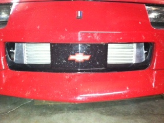

Very interesting information. Do you have pictures of how close it sits behind the bumper/grill? I have mounted mine up front right after the grill, but I am skeptical due to the relatively small surface area of the total core visible through the grill openings. I may potentially consider cutting the grill/bumper or re positioning if I start seeing high IAT's mine is a 31X12X4 Unit BTW.

It sits right behind the bumper just like the one in your pic. Dimensions of the vertical core are 27x12.5x3.

Nice intercooler install. Looks like I wasn't the first to think of a flowtie grill for a third gen.
