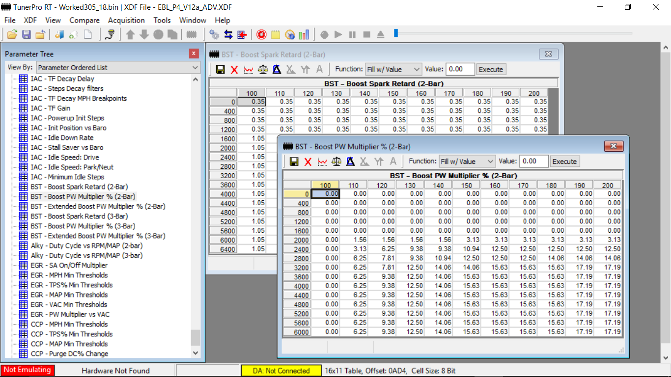

Re: Chronicles of a 9 Second Trans Am... Final Chapter
Not sure of Joe's area, but mine is very metropolitan. Was looking at Joe's video showing the blip of the throttle, how much stall speed are you running Joe? Years back RBob had explained to me why he avoided allowing for the EBL to VE Learn under boosted kPa, and it makes perfect sense. Tuning for boost is a breeze though,takes but a few minutes with the VE dialed in naturally aspirated...
- Rob

I find it hard to believe you cant find a secluded place on the street somewhere you can make some pulls to dial in a tune
It loses traction. It's absolutely impossible to go wide open on the street. I tried.

3000 stall. It seems like it revs to about 3200-3400 and then gets enough load to get into boost. At 4k the tires are on fire. I got it to 5psi a few times, but any more throttle and it lights the tires on fire.
-- Joe

even in high gear at 40-60 mph rolls? What tire is on it? If i can get 1100 ish to hook at high speed you should be ok. Really need a drag radial but even my 295 bridgestone potenzas hooked well at 500-600 whp

Easiest way would be to just hold the throttle in P/N and allow the MS to Learn the lower kPa portion of the mid through upper VE. You can blend those figures into the higher areas as close as you can from 70-100 kPa just as a reference point, then pull the intake tube from the throttle body and go out onto the highway for a few pulls and Learns and let the MS Learn the rest of the upper kPa portion of the VE table. If you're still getting boost in P/N, then pull the intake from the throttle body entirely.That should do the trick for under 100-kPa...

I was referring to wot boost tuning. You really do need to have decent tires for street pulls or have to go very high speeds to keep traction on non drag radials

No you're right Justin, I just looked at what he wrote and I misunderstood Joe, I thought he was having trouble out of boost to fine tune the VE, but it's in boost he's having trouble with because of location and tire spin. Now I see where you guys were going with tires, and I agree, Joe you need more tire. Even mine are currently 275 out back for the street. If you're running 16" rims, ask Diggler to sell you his 295 MT's, they would be perfect...
