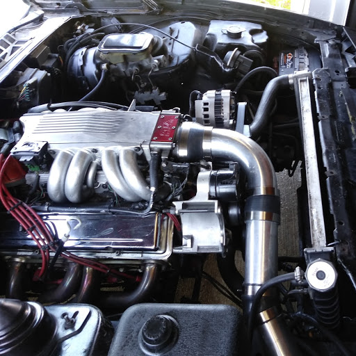

Re: Chronicles of a 9 Second Trans Am... Final Chapter
Originally Posted by Street Lethal
... as Ida is more than likely going to want to play with it when he dyno's it.
By the way, this is Ida Performance in case they sound familiar to my fellow OG's. Five minutes from my house. Long overdue dyno time with them. They are the only guys left in New Jersey that will even touch Tuner Pro, let alone know it inside and out...
Attached Thumbnails Chronicles of a 9 Second Trans Am... Final Chapter-tpi1.jpg   Chronicles of a 9 Second Trans Am... Final Chapter-tpi2.jpg   Chronicles of a 9 Second Trans Am... Final Chapter-tpi3.jpg   Chronicles of a 9 Second Trans Am... Final Chapter-tpi4.jpg   Chronicles of a 9 Second Trans Am... Final Chapter-tpi5.jpg
Chronicles of a 9 Second Trans Am... Final Chapter-tpi6.jpg   Chronicles of a 9 Second Trans Am... Final Chapter-tpi7.jpg

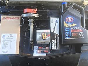

Also, wanted to share with you guys who are following along. Ever since I installed this replacement 305 I have had oil issues seeping out the front main seal on the timing chain cover at high RPM. Tried every conceivable fix, but it just kept happening. Then it dawned on me. Yes, prepare for a Homer Simpson moment lol... when I installed this 305, I replaced the rod bearings, put in fresh new oil w/filter, then primed the engine beforehand with a priming tool. Pictures were up, but photobucket has since become irrelevant, so the pictures aren't there earlier in this thread. The engine oil now seems to be stable between the Full mark and Add mark on the dipstick. Now, I know for a fact that the oil dipstick is the right one for this engine. I bought it from a local member. However, it still didn't dawn on me just yet why oil was shooting out the front and at high RPM only. It was overfilled. No doubt about it. Look at the oil filter I went with (Bosch), it is half the size of a normal filter. I completely forgot I went with that one, so even though I filled the engine with the correct amount of oil based on the larger filter that would hold a quart, I never compensated for the smaller oil filter which would normally hold half of a quart on its' own, which resulted in rising a tad too high at higher RPM because there was more oil in the pan, but is now stable between Full and Add...
- Rob
Attached Thumbnails Chronicles of a 9 Second Trans Am... Final Chapter-002.jpg
Old Apr 15, 2018 | 10:49 AM
  #492
DIGGLER's Avatar
Joined: Jun 2003
Posts: 3,059
Likes: 75
From: SC
overfilling one shouldnt make it leak, though. most likely a seal/gasket leaking.
It would have to be substantially overfilled. Ever drop 5 quarts in a stock oil pan to see how high up it goes? It doesn't even come close to the gaskets.
The crank counterweights would be churning it like butter.
Leaks suck. My blower is pissing oil for some reason, out of a spot it shouldn't be.
-- Joe

Guys, telling myself it's because of the oil filter is the only thing keeping me sane lol. The worst part is that it does not do that with the turbo hooked to the exhaust on a full oil pan, it only does it with a free flowing exhaust with no turbo, and only at high RPM, which would point to the damn piston rings. However, it is stable now where it is, regardless of RPM, so that is a good sign. Telling myself it is because of the smaller oil filter is what is keeping me from torching the damn car...
It's definitely coming from the front seal.
- Rob

if the balancer had any grooves worn into it, you need a repair sleeve for it.
also, excessive crankcase pressure will find any weak seals/gaskets quickly and spew oil out.
