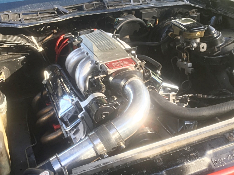

Alright guys, everything is connected minus the alternator and coolant. I'm loading a new starter bin that I am putting together, I essentially started with a stock LB9 bin but I made some timing changes, injector changes, IAC changes, etc. Gonna Flash it in now, then the first start is coming up. I will film the "true" first start, no changes or anything, just the loaded bin and the distributor timed by eye. Let's see what happens...

Okay guys this will be the last "still" update, the rest I'm hoping will be videos. The good people at Advanced Auto got back to me and said they found a set made by Dorman, I'm providing pics in case anyone needs part numbers ahead of time. Coolant is now in and ready to go. Exhaust is getting done tomorrow, but I won't post pics or update, the next update will be with a moving vehicle, preferably on the highway after a few VE Learns. Here is the set I nabbed, and one 5/8's and one 3/4's clamped on in the back...
Have a great weekend fella's...

Small update; VE Learns still pending. New narrowband wasn't putting the ECM into Closed Loop, and after confirming with RBob that the O2 sensor simply wasn't getting hot enough because of the long tubes, I then ordered a heated Bosch #13077 through Auto Zone. Yes, the heated AC Delco's have a much better rep as far as heated narrowbands go, but I can't wait for one to get here in the mail, it's gotta go in tomorrow, and to be honest I never had a problem with the Bosch one's in the past, usually the problems come from when switching back and forth to race gas at the track. Also need to redo valve lash, clackity clack.... don't talk back.
Adjusted them when the engine was in the garage, so I am not surprised they are loose and making noise. Forced to do it with the engine running though this time, and that part I am not looking forward to at all. Other than that the tune is pretty close sitting in Open Loop and untouched, so VE and fine tuning will be a breeze once I get the three wire narrowband in there. Y-Pipe is back off in the video because I had to go back down there and adjust the grommet in the transmission diptstick again, still seems to be leaking fluid. One out of the two lifters that were stuck still didn't free up yet. You can hear it clear as day when I tell my buddy to turn the engine off, it just falls back down onto the cam lobe. Damn thing better free up soon, I do not want to pull the intake off again. Yes, I gambled with it, I know I know...
Old Oct 19, 2016 | 07:57 PM
  #320
Street Lethal's Avatar
iTrader: (16)
Joined: Jul 2003
Posts: 10,538
Likes: 206
From: NYC / Jersey
Car: 1990 Trans Am GTA
Engine: Turbo 305 w/MS2
Re: Chronicles of a 9 Second Trans Am... Final Chapter
Update;
Never plan your tuning days, something always fawks it up. Had to pull the passenger header off to remove the transmission dipstick tube, and once pulled, the grommet had a big tear in it. Picked up a replacement from Dorman for three bucks at Advanced Auto, as well as more damn tranny fluid. Took most of the afternoon to do, because at first I needed to make sure the trans cooling lines were not loose, and I honestly forgot how hard that is with the trans in the vehicle. Wasn't quite sure if perhaps one of the lines kinked causing a tear by the saginaw fitting, and was cringing when I finally started the engine after replacing the trans dipstick grommet because if it was a crack in one of the cooling lines, well... just glad it wasn't. Luckily it was the grommet, trans leak issue is gone, all back to normal.
Effin grommet caused the delay, most of the day was wasted on a ridiculous trans leak.
The O2 sensor. Turns out the non heated O2 actually works, but it takes about two extra minutes to reach operating temperature. I brought it back anyway and got the heated O2 sensor in its' place. Easy hook up, just a pain in the @ss working around the long tubes, but it's grounded, has 12 volts key on, and is hooked to the ECM. Five VE Learns done so far, three with the non heated O2 sensor and two with the new one. Just idle Learns, taking it out on the street tomorrow...
Lifters. You were right Joe, it's better to set them with a running engine. I'll admit I should have just got new ones, but this engine isn't an ideal engine, so I was not looking to invest that much into it, and whatever I did invest can be used for a larger SBC if need be later on. I took this video for you Joe, look how loose they were after removing the slack and going half a turn more. This is after the engine was running, and with the lifters oiled. They are still loose after setting them a second time with the running engine, but definitely not as bad. It is what it is though, clack is essentially all gone (see below, this was after the first initial valve lash setting when I was assembling the engine on the ramp)...
Edit: Mark throw up that video you sent me, your 305 sounds freaking sweet...
