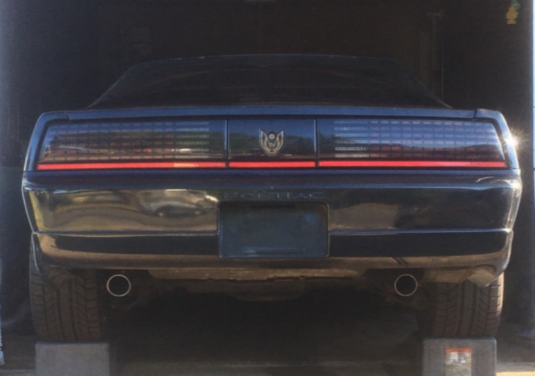

Well today was dedicated to the GTA, I hit a road block with the Buick, and that's because I have been racing it everywhere I have been taking it lol. Already ordered tubular control arms for the rear as one of the stockers gave up the ghost last night, cuz they are as thick as toothpicks lol, seriously. Can you say.... "snap"...

how in the hell did u manage to do that

At first I thought it was the e-brake dangling because when I installed new calipers, I left one of the old e-brake brackets that gets bolted to the caliper on when exchanging them, and the new one of course didn't have it, so I had to zippie tie one of them out of the way until I could get a replacement bracket. Figured the zippie tie broke and the e-brake was banging on the suspension. When I lifted the car, to my surprise, the control arm was cut in half. I would "like" to think it was the torque of the 3800 TPI lol, but I'm pretty sure the shocks are going and one good pot hole did the deed. Take a good look at the stock control arm diameter, that is how thick the stock exhaust is lol...

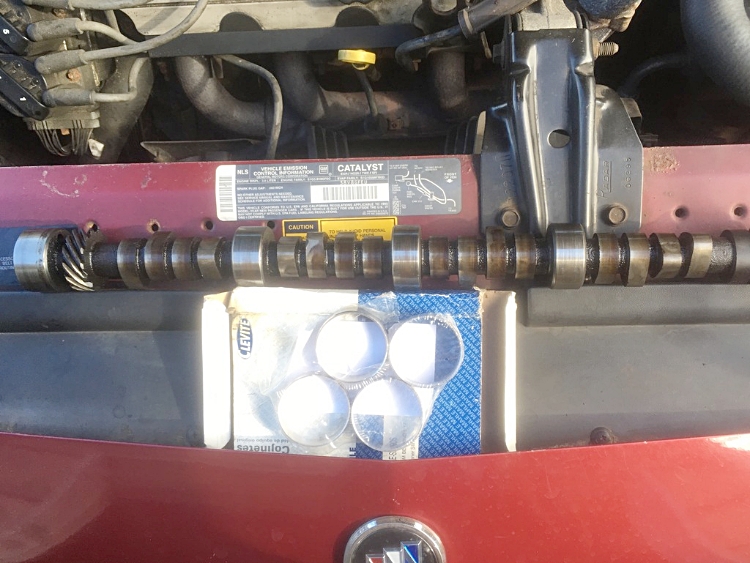

Originally Posted by anesthes
How do the cam bearings look?
-- Joe
The front bearing looks pretty good, but based on the feel of the four cam journals behind it, they do feel to be a little scratched, so I am assuming the bearings are scratched as well. As fate would have it I have four new bearings left from Clevite. The cam that I pulled looks to be a stocker, I have the numbers, but I don't want to waste time searching it...

engine tech is good stuff , most of there kits consist of king engine bearings, clevite ,speedpro or kieth black and sealed power stuff

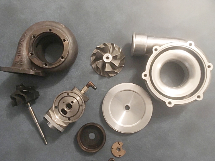

Okay, so the supercharger concept was scrapped, and I'm back to the turbo. The one I am going to use needs a rebuild, as after taking it apart over the weekend I found the shaft journal lightly scratched by the two bearing locations. So the bearings are out. I ordered a fresh rebuild kit, so it will get new bearings, thrust bearing, collar and seals. The shaft journal will be polished. Not sure why one of the thrust bearing retaining pins on the center section was pushed down, but I need to pull that back up as well. The exhaust side showed no signs of coked oil. It's a 72mm compressor wheel, .96 a/r on the exhaust side. Not going to bother with the RMT setup idea, just going back to the FMT setup I originally had, though I want to smooth down the welds on the system and have it coated. I might just spray it myself to save time. Gonna throw up that long tube header system for sale, so if anyone wants it locally hit me up. I paid $250.00 to the door, and I barely even used them, just a few idle vids. Going to put them up for $150.00 if anyone wants them...
You should get some STS or banks cast manifolds and do twins, with nice tight downpipe routing.
It would be nice to see a twin turbo thirdgen that didn't look like an abortion, had good plug access, and didn't melt anything within reach.

I came to my senses. Seven grand for a head unit and bracket, not worth it.
-- Joe
It's an awesome idea, but it would take too much time. I hate welding cast iron, and I would have to finish the set I started awhile back, get cast iron T3 flanges with wastegate flanges in them because I sold the ones I bought previously, cut and weld everything, then run 2 to 2 1/4" downpipes into a dual y-pipe that I saved from SLP. It would work, but the single system is ready to go, just gonna rebuild the turbo and put it all back on...
