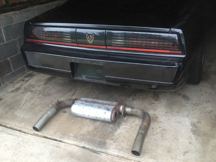

I am reusing the Flowmaster muffler that I was originally running on the GTA, but with a few changes. For starters, I hate the way the exhaust pipes stick out below the bumper, always did and always will, so the first thing I did was cut them about ten inches to tuck them neatly underneath the body. I then cut the 3 inch inlet going into the muffler in favor for a 4 inch inlet...
The picture below was early in the process as it only shows the cuts, but I since cut the clamps on the exhaust tubes attaching to the muffler and welded them shut. I also opened the orifice on the inlet of the muffler to 4 inches after marking it, then grinding it, then welded a short 4 inch elbow leading upward over the axle housing. I still have to polish the stainless steel tail pipes as well as paint the muffler and the rest of its' tubing high temp black. All that is left is finding a 4 inch up and over pipe, as well as a 4 inch intermediate pipe leading to the downpipe. Sounds easy yes, but 4 inch tubing gets expensive, so bear with me as I finalize the exhaust lol...
Deck lid is already painted in this picture, just need to wet sand and buff. Bumper's next.
