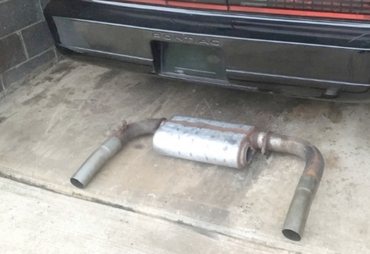

Well as per the tracking the long tubes are in New Jersey, but nothing came as of yet. Will of course give it until seven o'clock tonight, if not, then more than likely they will be here tomorrow. Going to have to fab their y-pipe a little and give it a 4" outlet, because I already welded a 4" inlet into the muffler I am using. These aren't that bad of an install, need to pull the oil filter, oil pressure sensor, pull the valve covers, notch the transmission cross member a little, as well as the bell housing ear on the passenger side where the converter cover bolts to, but other than that, should be a breeze to install. If they come with smaller than 1 3/4" (advertised size) primaries they are going right back lol...

Okay, just wrapped up the muffler end of the exhaust, the Flowmaster still has some life left in her. Here is a before and after below, I cut off the stock 3" clamps and welded the dual 3" pipes in, put back a 3" inlet into it, cut the original bracket arm that was welded to the intermediate pipe end entering the muffler, fabbed it a little, then welded it to the 3" passenger pipe. Polished the shortened exhaust ends, and hit it with 2000 degree black exhaust paint. Time to connect it all together...;
Before...
After...

I would not use that muffler lol

Looks good! Aslong as theres no broken baffles i dont see why not

F1 blower thru a 80 series?
Has anyone seen a chambered muffler vs a high hp engine backfire?

Doesn't matter which muffler with an electric cutout lol.

You still don't get it, I am running a larger supercharger to bring boost in earlier, albeit metered by the wastegate. The F1A will provide the same amount of boost pressure as the D1SC, just earlier and more efficiently. This engine won't last one run with the amount of horsepower you are speculating, this is a street car. The exhaust will be vented way before it reaches the muffler anyway with the cutout when it sees high boost pressure, so the type of muffler is irrelevant...

In that case you are ok, just use it whenever you go wot, else you'll be down on power. Those arent good enough for 9 sec power

Oh i get it. How you make the power is irrelevent. What matters is if you expected to use the muffler for wot. The cutout was not mentioned anywhere unless i missed it.
A blower car needs to get exhaust out as best it can. On a turbo, preturbo can be smaller but post turbo its same concept. Theres alot of evhaust gas to get out. You know this
Cutout will save you, but as above, run it at wot or it will be restrictive
And what you mean it wont last with the power i am speculating? The thread says 9 sec. You mentioned 135 mph. I have been there and know what power it takes to get these cars there. Thats why you went with the F1a
If you dont think it will last then change the thread title and then i must ask why the F1a once again lol
