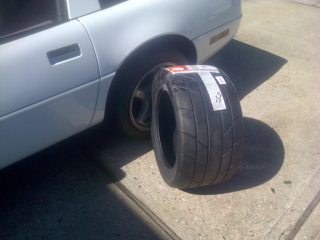

That's what I had my 315's on, my old C4 with 11" ZR1 rims.
I hesitate putting them on 9.5" TT rims, considering stretching the rims out...

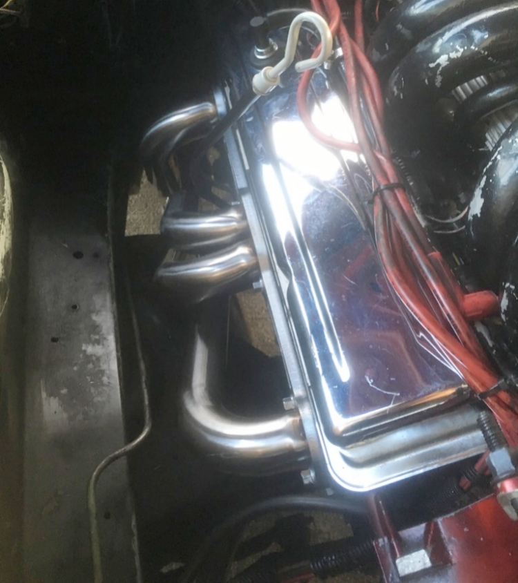

What do you mean modify the floor for the O2 sensor? Are you running your wideband in that location? I put my narrowband in that location, fits good, but will be welding an O2 bung into the y-pipe collector for my wideband. So far everything fits perfectly, and believe it or not, despite cutting the corner of the tranny's bell-housing off where the dust cover bolts to, I realized I didn't even have to do that. They actually went in very easily. Anyways, these pics were taken after bolted down. Spark plugs are in, wires will be shortened and run overhead. When I pulled the starter I seen that one of the three fusible links' terminals were broken off, so I need to correct that before reinstalling the starter. Wanna get this on the road as soon as I can, so hopefully today I will have an exhaust clip for the thread...

Yeah. What's the narrowband for??
I have AFR heads which raise the exhaust ports a little bit, so my headers are a little closer to the floor than yours probably.
