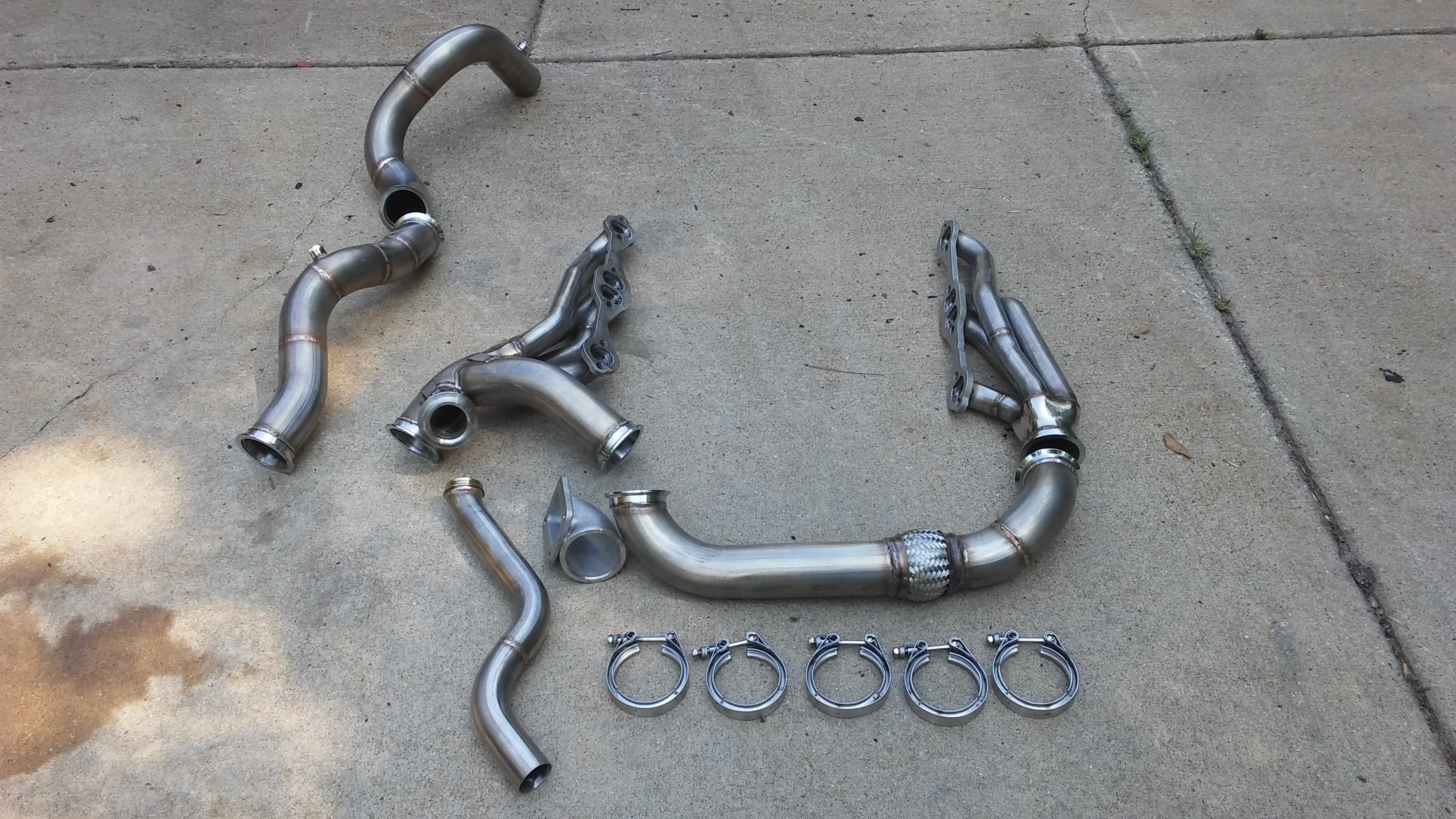

I wanted to change out the log style BBS turbo header for along time and I've finally pulled the trigger again. I noticed this new kit from CX Racing just the hot side, so I decided to test it out.
http://www.cxracing.com/mm5/merchant...Code=Camaro-LS
This is what I started with:
Attached Thumbnails UPDATE: Changed hot side, went tubular. Testing CX Racing's new kit for 3rd Gens.-0827161109.jpg

Certainly interested in that. Didnt know they had a kit

I didn't either until I came across it on ebay and took a closer look. They have the exact same kit for an LSX swapped 3rd gen too. http://www.cxracing.com/mm5/merchant...gory_Code=TOKT
Its so amazing that none of these kits existed when BBS came out with their kit.
For me I think CX Racing just gave 3rd gen owners a new hope. I mean the quality is amazing and with some modification to the car this kit has some serious potential. So buyers please be aware that this kit is still not a plug-n-play kit, you will have to make things work around it. But it is a very good starting point for the price.

looks like CX Racing isn't making the full kit anymore for thirdgens with the LS engine. they are now only offering cold side piping.
http://www.cxracing.com/mm5/merchant...Camaro8292-LS1
wish i had the money to buy this kit when people first started talking about it. maybe they just took it down so you couldn't get a discount on black friday / cyber monday.

These two parts are major pieces of the puzzle along with other supporting mods that keep the trans happy. I've built countless transmissions for friends and other customers with great results so far. I use my car as a testament of how well the parts hold up! Also I'm still using 4 gear planets too. But trust me I have a set of GM 5 gear planets on standby and not those cheap knock off ones that break all the time.
https://www.summitracing.com/parts/sox-77733-10k
https://www.summitracing.com/parts/sox-77749-02k
Keep in mind when you receive your new Smart Tech Drum, you will have to upgrade some components in the drum ie; upgrade to the 97'-Later model ring gear because the ring splines are taller for the 3-4 clutches/steels and has a torrington bearing instead of a brass bushing that rest on top of the sun shell, a steel forward piston is recommended instead of aluminum, You will also have to use a 91'-Later apply Ring with a "7" stamped on it. Finally, a 97'-Later Dual-Cage Return Spring for the newer designed Overrun piston that comes with the drum.
If anyone have any question just send a PM.
