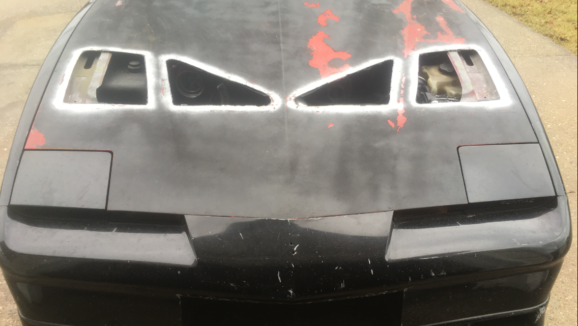

See, now that's what I'm talking about. Was up late last night cutting and sanding, and pounding this donor hood into submission (hehe), when I reached out to a fellow New Yorker who used to run an '89 Formy on the board. Lost track of Eric awhile back, but somehow I ran across his old video of his Formula on youtube while playing from my playlist, but he has a new UserID. Hmm, needed to investigate. Checked out his vids and noticed he very recently nabbed a newer C7 he's playing around with, blown no less. After some small talk, asked if he wanted to roll when I'm back on the road, and he said yeah. No hesitation whatsoever. Oh hellz yeah, I'm loving it.
See? He's not afraid of a slow 305...
- Rob

... any-vay, hood is almost done. I can see I'm making a mistake and falling into a "how to" thread again, so I'm just going to show you guys the byproduct when it's done. and move on.

I'm home today, and the weather, allegedly, is supposed to be 65 degrees. I'm going to finish smoothing down the edges of the cuts I made in the hood and make them perfect until then because it's still 40 degrees out, and once I am happy with the finish, I will sand it and shoot it with some primer. And if the weather does in fact get that warm in terms of 65 degrees, then I'll start banging out the oil lines for the turbo that is now seen "peeking" out of the hood lol...

Was trying to find honeycomb cut steel screens, but no luck. I do have diamond cut though, more than likely going with them. Still smoothing the cuts. Almost done w/the hood, once the screens are in paint is next. Already hit the structure under the screens Black. It's raining out by the way, might see some droplets on the paint, but it's been dry for awhile, it's fine...
Edit: Itching to throw another turbo onto it, but I'll wait.

One set of screens are in. Still need to remove the hood and secure the screens in to flatten them out, not to mention paint them Black along with the hood. We're getting snow again today, no big surprise to me anymore. Prolly finish the screens up today, but obviously wait for a warmer day before painting the hood and around the windshield...

Having a freak of a day today, house thermostat is reading almost 80 degrees with the heat off. Gonna attack the rest of the hood today, no question. Already hit around the windshield and the sides of the hood, but today I'll bang out the top of the hood. Will wet sand and buff when all is said and done, because I need to hit the headlight covers and front bumper next, but that's later. Screens were pulled, trimmed some more, and have been sandwiched between two pieces of wood to force them to stay flat. So far so good. However the liquid weld idea was scrapped. Cousin had a point, if I need to replace them in case someone kicks up a rock on the highway, it's easier to remove them from silicone rather than liquid weld. Anyways, hood is getting done today...

Better to actually hold them on with mechanical fasteners.
Tack weld some small posts to the hood, and then use push nuts to hold the screen in place. (posts go through the screen).
-- Joe

Joe that is a perfect idea. Now I have to hit up Home Depot for the pieces...

On fiberglass hoods, snowmobiles, etc they have the posts molded in or epoxied. Same principal, push nuts to retain the screens. they use a heavy gauge screen so it doesn't look wrinkled.

One side done, screen is as stretched as it will ever be. Onto the next. Out here welding with only sunglasses and no gloves because I am in a freaking rush racing the damn light. On a side note, I pulled the EBL-P4 down to wire in a different wideband in the other day that I picked up, and the freaking memcal is missing (need it for spark control). I don't even remember what I freaking did with it. Now I have to hit up Brian at Tuned Performance to see if he has an extra one lying around. I do know I can wire up an ESC from a MAF setup which will work fine, and believe it or not I have what I would need to do it, but I'm done wiring this car. Replacement memcal time. My fault, though I'm sure it will turn up after I buy its' replacement <sigh>...
