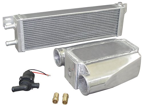

I decided to let it go. I have no desire to build something that's too fast for me to run at the track, and as I'm getting older I'm losing interest in race cars and more interested in collector cars (Corvettes, 30s fords, etc).
I bought a T-Trim from 89gta383, which seems like it fits my L31 vortech brackets (passenger side mount). With only minor denting of the wheel well.
Right now I have a 6" crank pulley and 3.33" blower pulley, 10 rib. I have the air-water intercooler. If I can get a reliable (as in I could go on a 4 hour cruise if I wanted to without coming back on a flat bed) 600+ hp out of it, and trap 120+ mph I'll be more than pleased with the car.
The J trim is just a huge blower, and even mounting it was a choir. Under driving it didn't make much sense. The T-Trim flows only a few hundred CFM shy of the J trim but does it in a smaller package.
-- Joe

I'd like to run the heat exchanger right next to my trans cooler (rather than in front of it). I've been looking at this 12x12 radiator on ebay. It's got small tanks and a cap. Was thinking put a 10" fan on it and see how it does:
http://www.ebay.com/itm/401123669287?_trksid=p2060353.m1438.l2649&ssPageName=STRK%3AMEBIDX%3AIT
I've got the intercooler, the cobra pump, and hoses. Just need to mount it all. I've got a box of pipes and bends and silicone, but I might need a 2.75-3.0 transition out of the blower. Was thinking start with that, and If I still have heat soak I could add a 3 gallon tank somewhere.
I don't know what it's going to make for boost. I'm gonna spin it around 45k eventually. I'm hoping it makes between 600-650 crank HP. I figure, I've got 57 more cubic inches, better heads, and a slightly better blower(T vs S trim) than my last thirdgen and that made 565hp.. It's gotta be faster, right?!?
