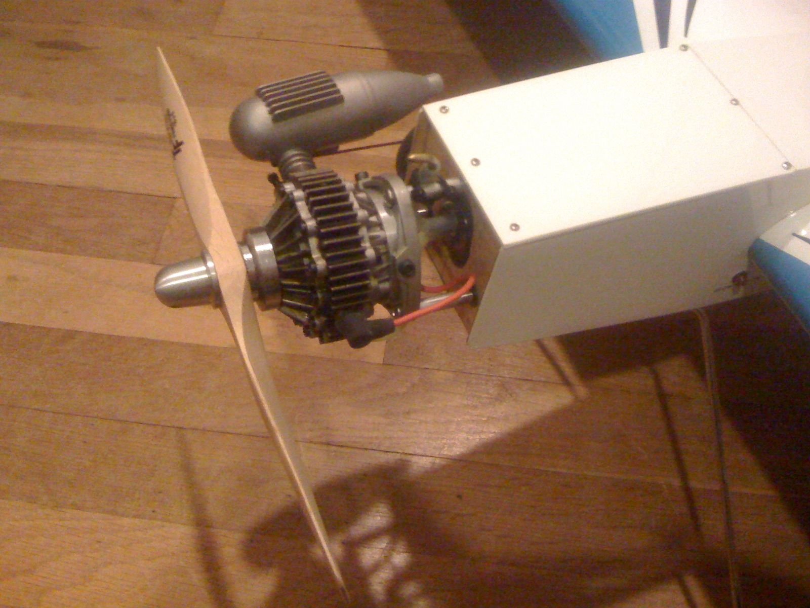

Hi rx7speed , I hope the thread's participants will pardon the off topic post , I saw your sig of loving to play with your Wankel and figured I'd show mine . This is a true Wankel engine of .30 cubic inch displacement that pulls a 5 pound RC model airplane through the skies nicely . In a world of piston engines the Wankel truly stands apart and while many know of the RX-7 very few know of the world's smallest production Wankel , My O.S. engines co. version
