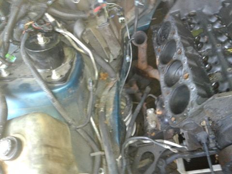

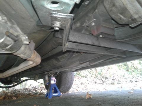

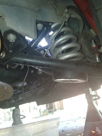

You guys like pictures so here is where I am at!

Getting 300 wheel with tbi 305 is gonna be a tallll order imo. Heads and intake may need work and may want some compression. Might need cam in the 220’s range
