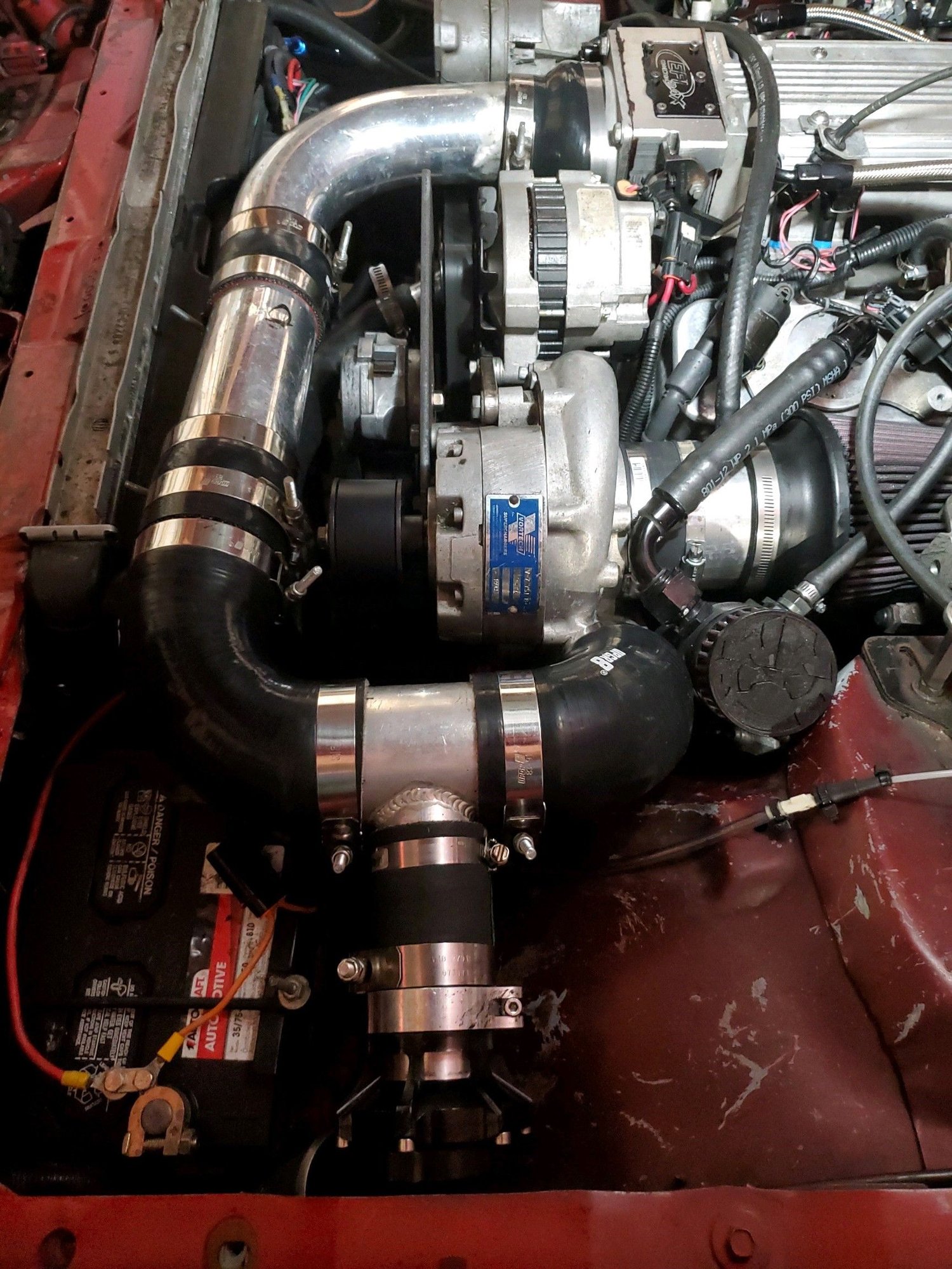

Current status - T-Trim on 412"
I've got my tune dialed in pretty good now, but I found breakups when my AFR was richer than 11:1 under boost. Some guys think it's due to my plug gap being wide (.044), although it should make more power leaner than 11:5 anyway so that's where I'm dialed in now. I may close the gap a little bit, but I've always been told run the widest gap you can for the AFR you want to run.
Biggest 'issue' I have now is I'm just not seeing as much boost as I'd expect from the impeller speed. I'm going to hook up a second map sensor before my IC to determine if that's causing a lot of pressure drop. If not, and if the 6.8l engine is just too consuming for the t-trim, I'll probably just ramp the timing back out to where it would be naturally aspirated.
If anyone cares, the numbers are:
RPM 5800 (cam doesn't make power past that - nx276hr12)
Impeller speed 47,000
Boost 5.1ish PSI
Ambient temp 68*
IAT temp 91* in boost
Outlet temp of blower 220+ degrees
Timing 22*
The max efficient impeller speed on this blower is around 45,000 so putting a smaller blower pulley to make more boost doesn't make much sense. No apparent boost leaks, so I suspect the cheap air-to-air IC is restrictive or the blower is too small for the motor.
SO I'm going to add a second MAP for recording. I know there is some pressure loss due to density changes with the IC, which I think you can calculate based on in/out temperature, but if the pressure drop is significant I might switch to the air/water IC I have on the shelf.
If pressure drop isn't a huge deal, I'll probably just ramp the timing in, maybe 28 degrees or so.
​​​​​​​-- Joe

I have a 4 inch tube feeding my 58 mm tb with silicone connector also. I measured pressure in the intake pipe after the intercooler (and before the tb) and at the map sensor (after the tb) and get about the same pressure reading. I would think if my pressure after the tb is lower than the tb would be a restriction, but I don't think so.
When i did my boost leak test, i found maybe 20 different leaks. I have worm gear clamps on everything now, from the brake booster connection to the you name it. My biggest leaker was the throttle body. That opening under the TPS sensor and under the spring on the throttle shaft where it goes into the body was this biggest leaker of boost. Take it apart and get some o-rings from napa and put some high temp grease on them and shove them against the shafts. Under the tps sensor, I had to put a rubber washer there to get it to seal. Before I did my boost leak test, I could only get 5 psi in the system and you could hear air coming from the throttle body, now the guage rolls up to almost 30 psi before it blows the leak tester off the outlet of the blower. After spending time fixing all these leaks, I picked up about 1.5 pounds of boost.

Tell me about it. I have been trying to find my missing boost for 2 years now and i found most of it. Let me share what i found out. I have a port at the end of the ysi to put a pressure sensor or screw in bung. I have that port going to my boost gauge in the car. I have been fighting this for a long time. When i dyno'd last year, they measured boost at the outlet of the blower at 23 lbs with the 2.75 and 7.8 pulley combo at 6450 rpm. The motor map sensor only saw 13 lbs. That is a loss of 10 lbs. I had a 4inch ebay intercooler that everyone thought was the issue, so a local fab shop made me a garret intercooler from scratch with 3 inch inlet and 4 inch outlet. This garret core is supposed to have less than a 0.5lb pressure drop.
I just did an experiment yesterday where i bypassed all of the intercooler piping and intercooler and ran 3 inch pipe from the outlet of the blower straight to the throttle body. Same pulley combo got me 20.5lbs at the motor map sensor. IAT's are 250+ as my iat sensor maxes out at 250 without the intercooler. With the intercooler, iat's are 90-100 which means the i/c is pulling out 200 degrees of temp which is good. I have run it with a straight pipe in place of the intercooler and picked up 3 lbs, so the intercooler is only costing me 3lbs, but it should be less than that.
I made 13 lbs with that t-trim with the 2.95 and 7.8 pulleys which is why i thought i needed more blower. Turns out it was my intake piping and intercooler the whole time.
Take a look at my picture and try this experiment of running the pipes straight from the blower to the throttle body and see what happens. You have to experiment sometimes like was said above me.
Old Sep 5, 2020 | 11:59 AM

So you were losing 10 lbs thru the ebay cooler. Without anything you only lost 3 lbs (saw 20 psi). with the new garrett core you lost 3 lbs over no cooler (Saw 17 psi?)
not bad but still more than i would expect
With the ebay cooler and full intake tubing, loss was 10 lbs
With the garret cooler and full intake tubing loss was 8 lbs
With no i/c and no full intake tubing (shortest tubing only) loss was 1.5 lbs. I might be loosing .5 lb from a leak in my boost guage hose as i was playing around with that hose and knew it leaked.
I played around with so many pulley combos that skewed the non intercooler with full piping results, but i still never saw 20.5 lbs like i did yesterday with short intake tubing and no ic.
Hard to imagine that you could lose boost from intake tubing only. I found some stuff on the internet about the expected loss from air drag through intake tubing is about 1 lb per 10 lbs of boost. I have 2 90 degree silicone couplers on my short pipe now that i will swap out for aluminum 90 degree bends and see if that give me back the 2.5 lbs I am missing.
