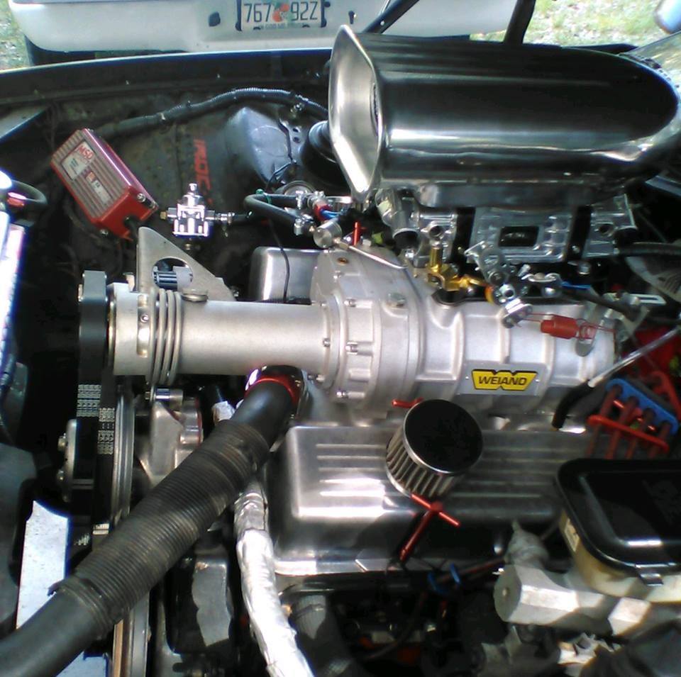

I ran an 11.5:1 motor with a small 142 weiand supercharger. It has forged pistons, crank, and rods,...also the ring gaps are opened up for power adder. Ran on 93 pump gas with 30 degrees total timing. Ran 7psi of boost, then 10 with a smaller pulley. Didnt break any records but sure was a lot of fun. Currently have that same engine in an S-10 doing a twin turbo build. With mild boost i wouldnt be concerned about the compression at all. The ring gap would be my first concern.
